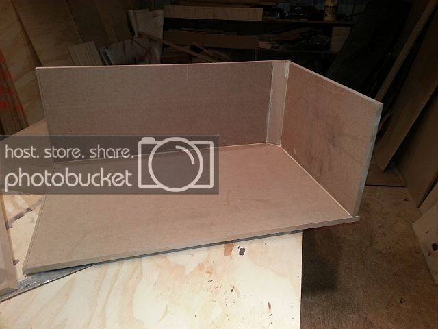

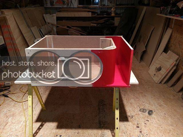

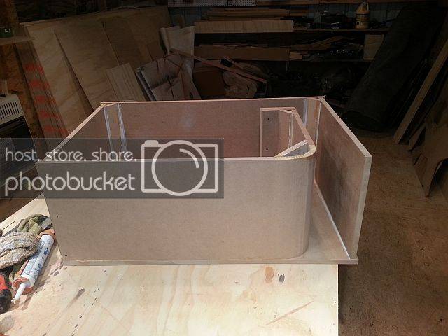

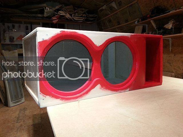

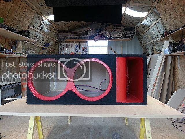

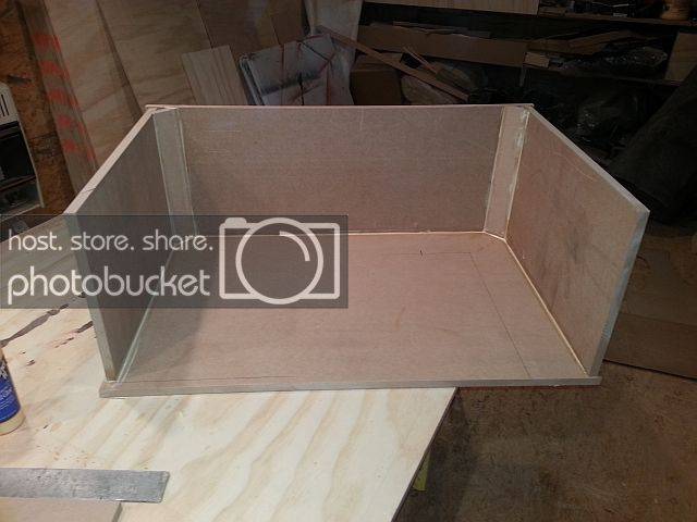

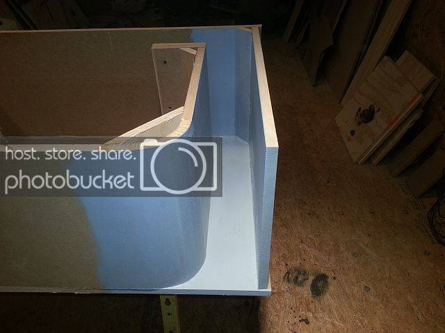

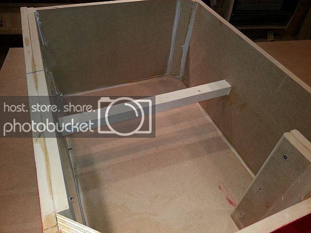

This is for a pair of XFL 12s.....4 cubes net...33hz.......going to be flush mount, black carpet, cherry red kerf port.......
Thanks D.........Only time will tell.........I feel like this is going to be the year for the BIG BOXES....I have a four OA 18" enclosure on the horizon......//content.invisioncic.com/y282845/emoticons/smile.gif.1ebc41e1811405b213edfc4622c41e27.gif
Oh wow nice! That'll be a fun one bet it'll be loud as hell
I'd tell you how it sounds, but upon removing my old box I found out my trunk is leaking... Got it all siliconed up tonight and I'm letting it all dry out overnight. I should have pictures of it in the car tomorrow!
