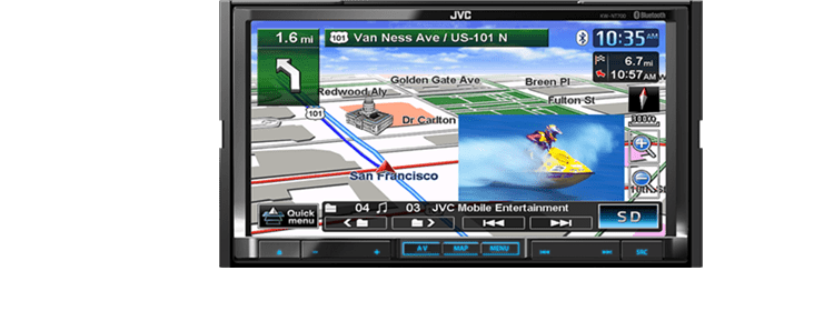

Going to be doing a bit of upgrades to the truck which include...
New JVC KW-NT700J Navi unit
