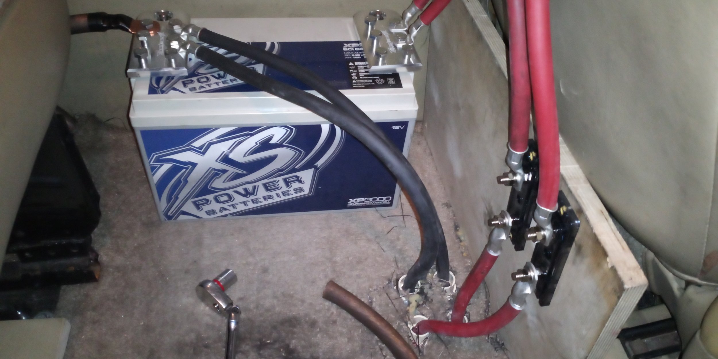

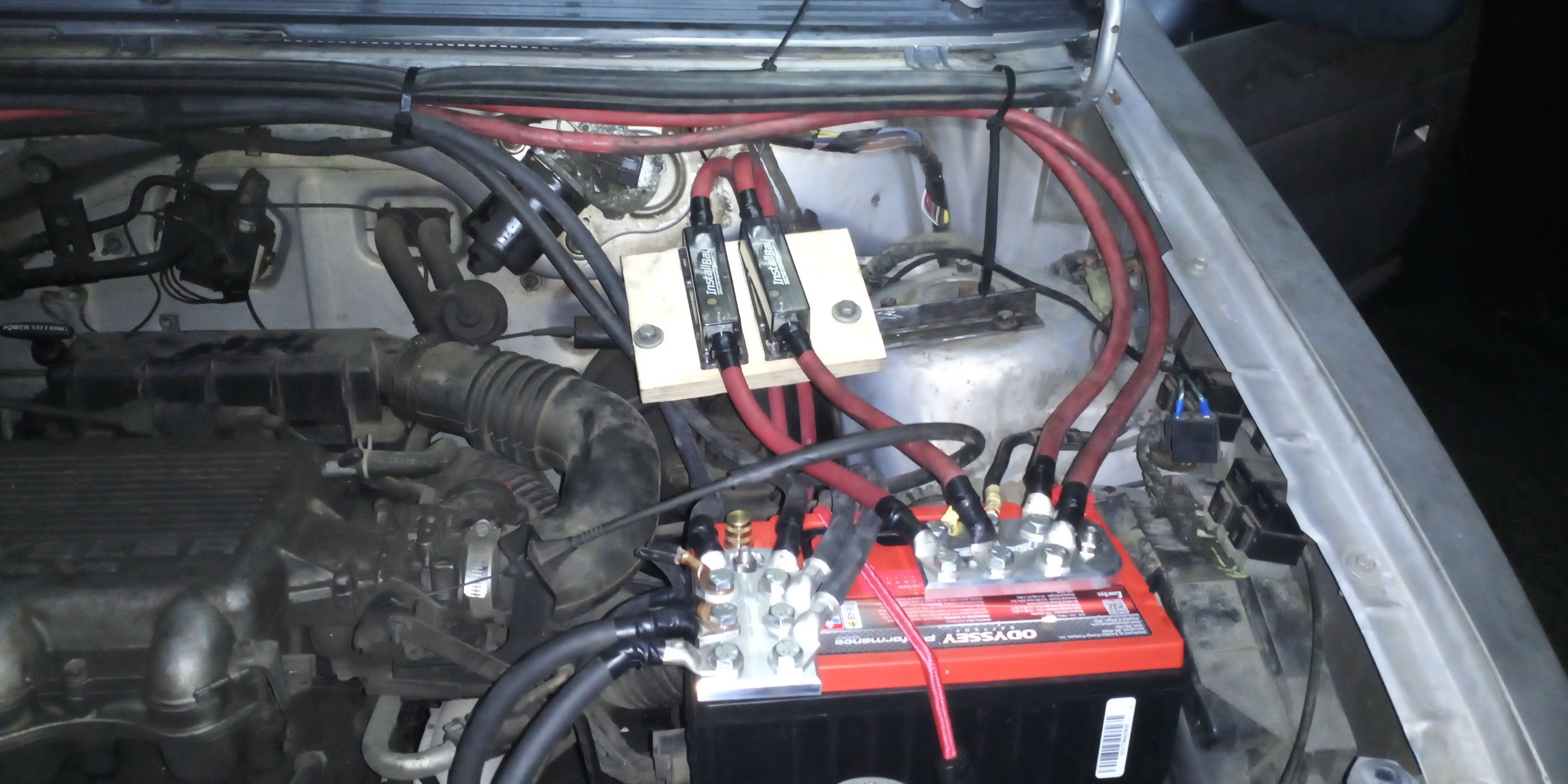

I have a question for you bro, I ended up getting the Salt4k. It'll be here tomorrow. Because of stupid virus stuff going on I cant get any more 300a fuses. Can I run 200a on one run in the 3 fuse spots between the start battery, rear battery, and amp and 300a on the other side? Or can I do 200a in the 2 fuse blocks between the start battery and rear battery on both runs and a 300a in the 2 runs going into the amp from the rear battery. It will only be for a day or so. I ordered a box of 300a fuses... Or would I be better off just doing 200a fuses all around until the 300s come?
