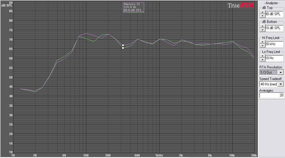

Example, this was a tuning effort last year, mic at each headrest:
without sub

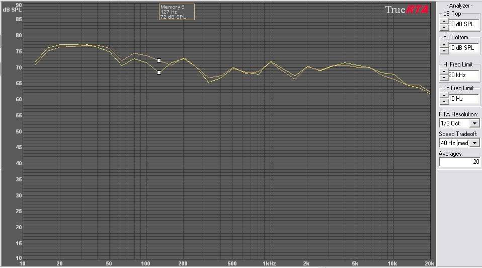

with sub

This is the reason I am thinking of going with the computer software, mainly the easy comparisons and ability to save and compare. The second picture down, does the separate peaks between the speakers around the 1100 hz to 1300hz area denote signal reproduction differences, or time arrival differences, and if it is time arrival, do I superimpose the green speaker to the left to the purple, or purple to the right to the green, and then would the delay be applied to the left speaker or right to get the right response movement?
This is gonna be fun, but I am way out of my comfort zone with things like this^^^. I am hoping I am just making it harder than it will actually be.
Arrival times don't shift frequency, just affect phase interference - I.e. amplitude. Peaks could be reflections. Those two peaks are likely constructive interference. If they are within 3dB you won't notice. We barely perceive a 2dB difference of single tones. My goal is to be within 5dB peak-to-peak in the vocal range. That results in a pretty natural reproduction.
Also, test various mic positions.
