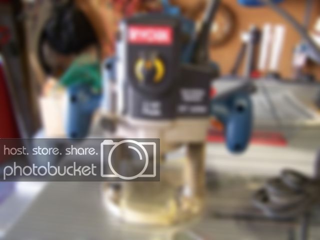

well here is a pic of my router:
do you think this will work for me? is it cheap? i have no clue

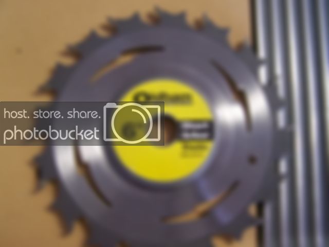

also the guy i bought a table saw from gave me a blade that i have no clue about
here it is:
You need to buy 1/2" bits. Most of the cheaper stuff is 1/4." If you got it new, though, I would expect that they included an adapter to use the 1/4" bits.
no didn't get it new. its used. i got it with the table saw in the picture. it also came with the table to mount it.
Get a ruler out and check out how big the hole is. (The whole in which you would stick the bit). It will be 1/2" or 1/4", or maybe like 1/32" larger than those sizes, depending on if it is loose or tightened.
That's the first thing you should do before shopping.
yeah wtf is that for? groves?
Basically, yes. Have you tried searching for these things? Type dado into google. It just scares me that you own this equipment without knowing some of these things. If you don't know the answers to simple things like these, I can't imagine you can safely use the equipment.. but that's just my $0.02. Not trying to offend you or anything.
