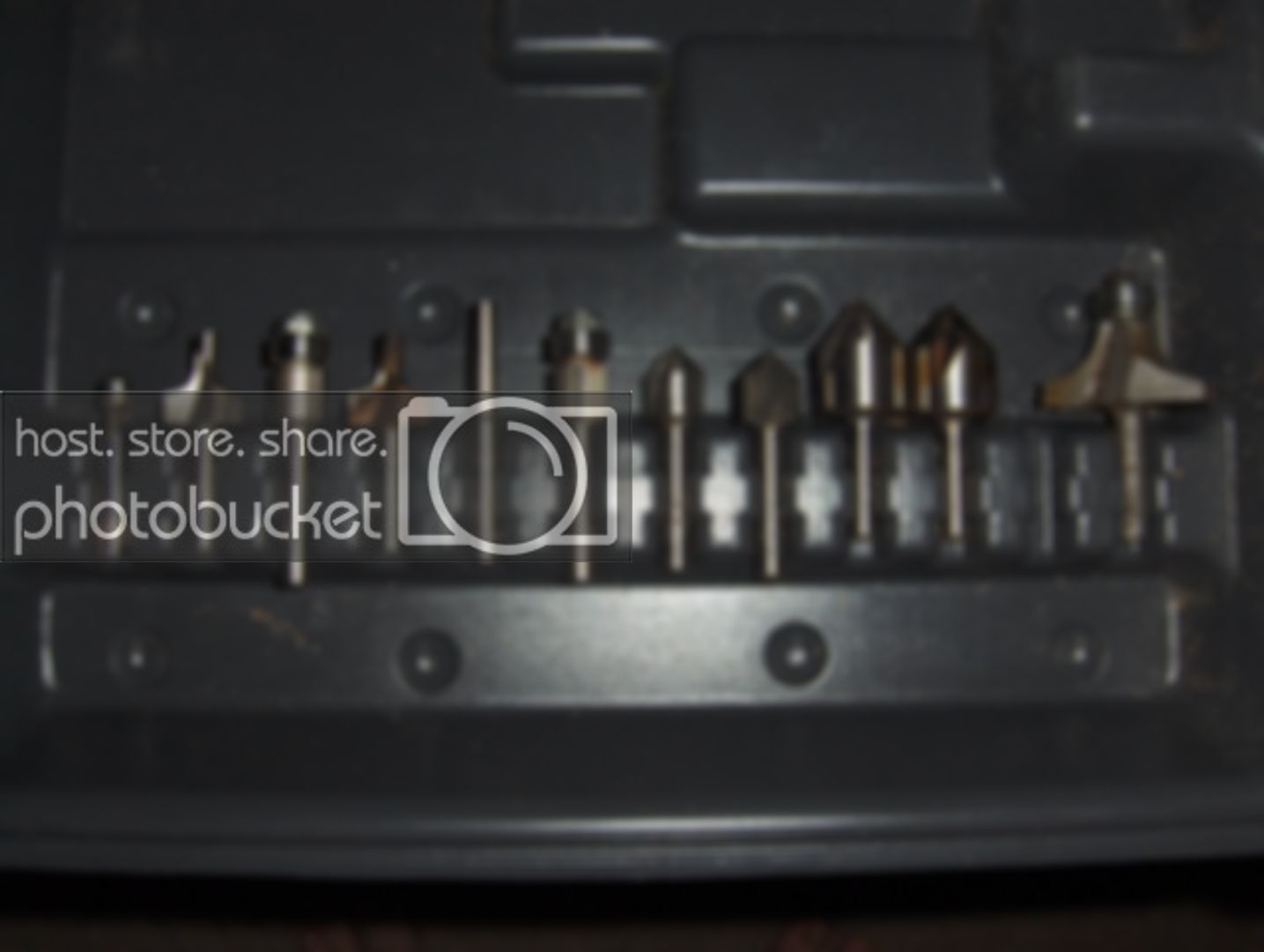

I just got a router for xmas, my dad gave me his that i didnt know he had, or i would of asked him a LONG time ago //content.invisioncic.com/y282845/emoticons/crap.gif.7f4dd41e3e9b23fbd170a1ee6f65cecc.gif its a Skil 1 3/4hp with some bits, heres a pic of the bits... can anyone identify whether or not i have a straight, roundover, and flush trim?
im thinking the 5th from the left is the straight cut, and the last one all the way to the right is a roundover?.., but not 100% sure. havent used it yet

#3 and #6 from the left are flush trims, although those look like they're meant for veneer work, you need longer ones for trimming up enclosure edges with 3/4" material.
#1 is the veneer flush trim bit #3 and #6 look to be regular old 1/2" flush trim bits. But yep, gonna need longer than that //content.invisioncic.com/y282845/emoticons/smile.gif.1ebc41e1811405b213edfc4622c41e27.gif

You can use that stright bit in the kit for circle, but go slowly. A spiral upcut bit will work faster and last longer tho. They're the ones that look like a drill bit.
Also make sure the roundover bit you get has a bearing, some of the cheaper ones dont..
