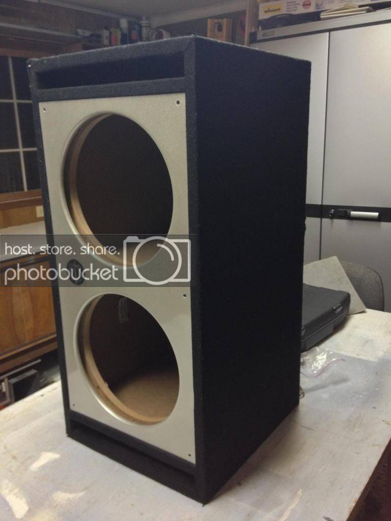

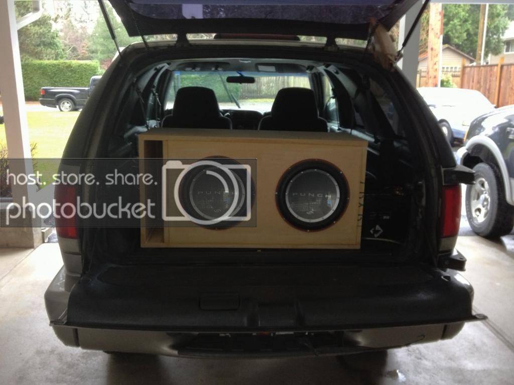

Got the box done it sounds amazing compared to the prefab. Hits way more frequencies and sounds cleaner. Here are some pics of the prefab and the new one.

You know what man, I seriously just shed a **** tear. So AWESOME to see someone put those vids to good use and create a legit box! Please do me a favor and check your pm's.
