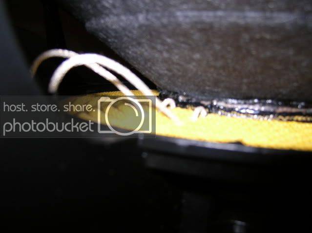

totally depends the recone. i would stay clear from a sloppy recone cause that shows they havent done many or know really what they are doing. bad glue joints,coil rub stuff like that....

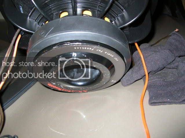

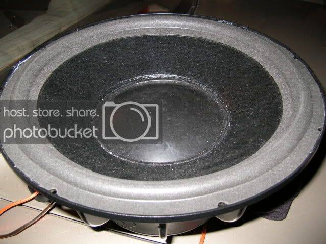

i was told there in no coil rub the guy reconed it sold it then then it was sold again up for sale just has some glue all over the place on the recone. it has seen some basic power to just test it but has not been pushed where talkin about the re se love the triple stack bro. how about the RF there from what 99 and can take 1000 all day ? i wana do 3 cubic feet net then drop the sub in tune to 32 off a ap 1800 thats 1000 watts at 2 ohms or mayb a ap 2200 at 2 ohms. i have to get the money order out today.
pics
wich sub the re se or the old school Rf i like the Re cuz its what i was looking for but i like the old school sub. not sure if it will really take the 1200 all day
It was originally rated for 1K , so i'm sure itll be ok with 1200. That things got a 4" Coil , it'll handle some juice. got any T/S parameters for it post recone?
the stock form calls for 1k all day everyday the surrround has me nervous . some specs oh yea the ported box dont seam good. some one tell me what box for 1000 tune to 32?
Coil Diameter "4" 4Ω x 2 fs 20Hz Qts 0.35 Vas (ft3)9.182 Vas (liters) 260 Xmax (in.) 0.53 Xmax (mm) 13.5 Sensitivity (dB @1w/1m) 89 Power Handling (RMS/Peak) 1000/2000 Speaker Displacement (ft3) 0.25 Mounting Diameter (in.) 13-7/8" Mounting Diameter (mm) 352 Mounting Depth (in.) " 7-1/4" Mounting Depth (mm) 184 ENCLOSURE VOLUME Sealed (ft3) 2.5 ft3 Sealed (liters) 0 70.79 Vented (ft3) 2.5 ft3 Vented (liters) 70.79 -
