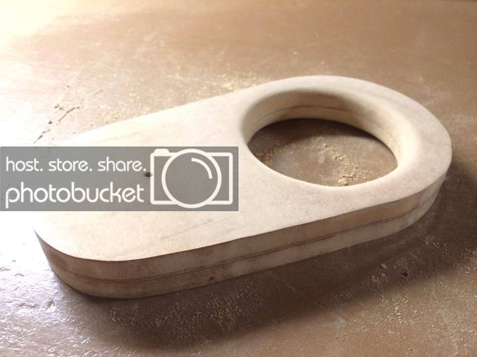

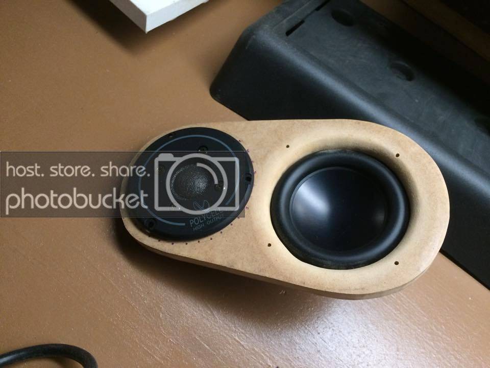

I started by getting on the router and making 4 identical cutouts from 1/2" MDF, and sanded them down to baby bottom smooth.
Then, I used a circle saw to cut a hole for the Dayton, and used a roundover bit on the router to round the edge.
