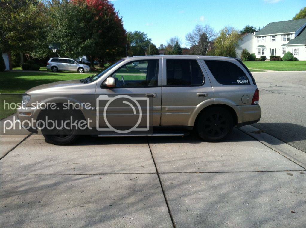

Well, times are changing, and my thirst for audio is too. The vehicle, my 2005 Buick Rainier, has current mods of:
- 4" Belltech Suspension Lowering Kit - Springs, Shocks, and Struts.
- Spohn Adjustable Panhard Bar
- DJM Sway Bar
- Poly Bushings
- MaxxLink Shortened Endlinks
- Roof Rack Delete
- Plasti-Dipped trim and wheels
- 6000k HID Headlights and Fogs

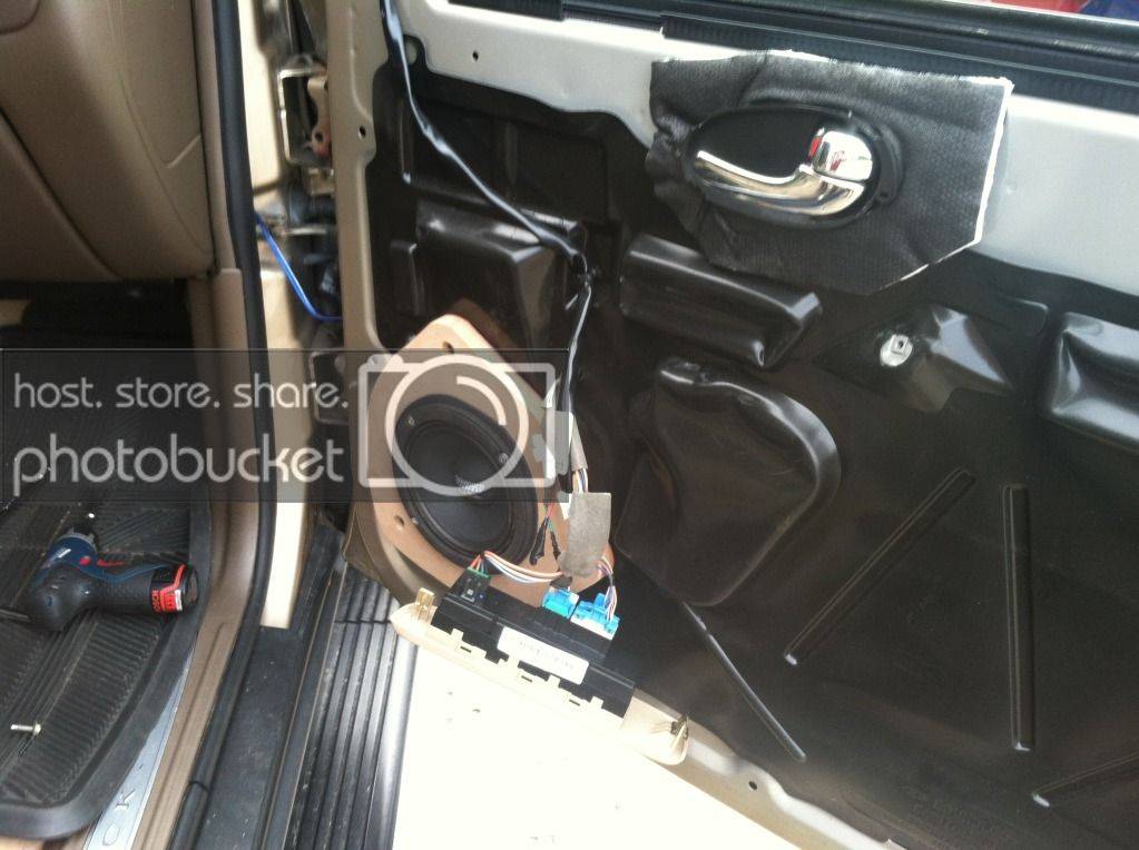

Recently, as you can see in the picture above, the motors of my E8V3's fell off, so I'm planning something bigger and better. Sundown is honoring their warranty, and allowing me to upgrade with warranty added.

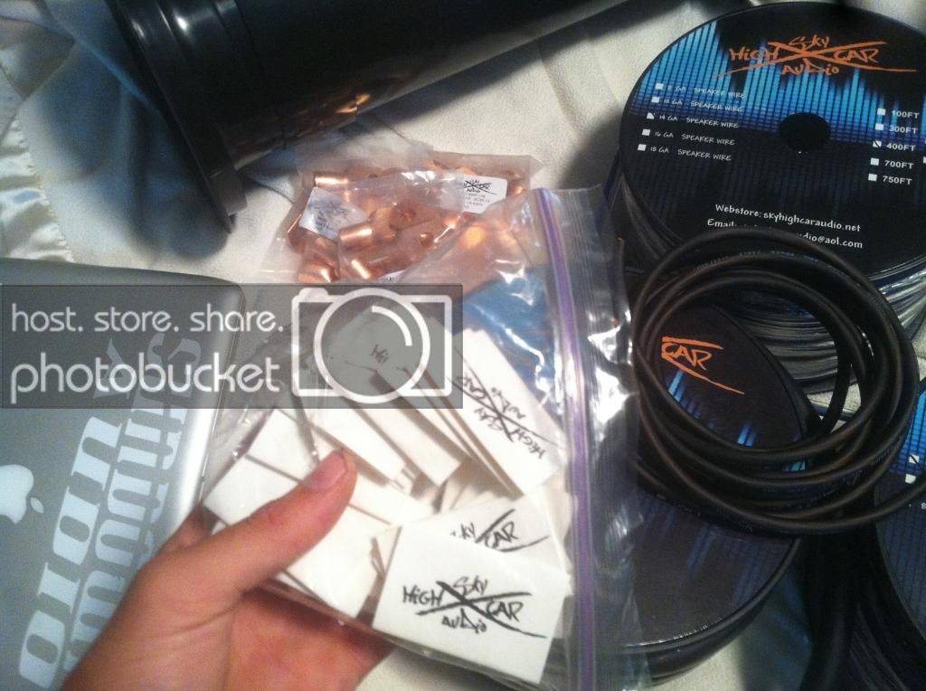

- Sky High Car Audio Cable - 2 Runs of 1/0 power, and 2 Runs of 1/0 ground

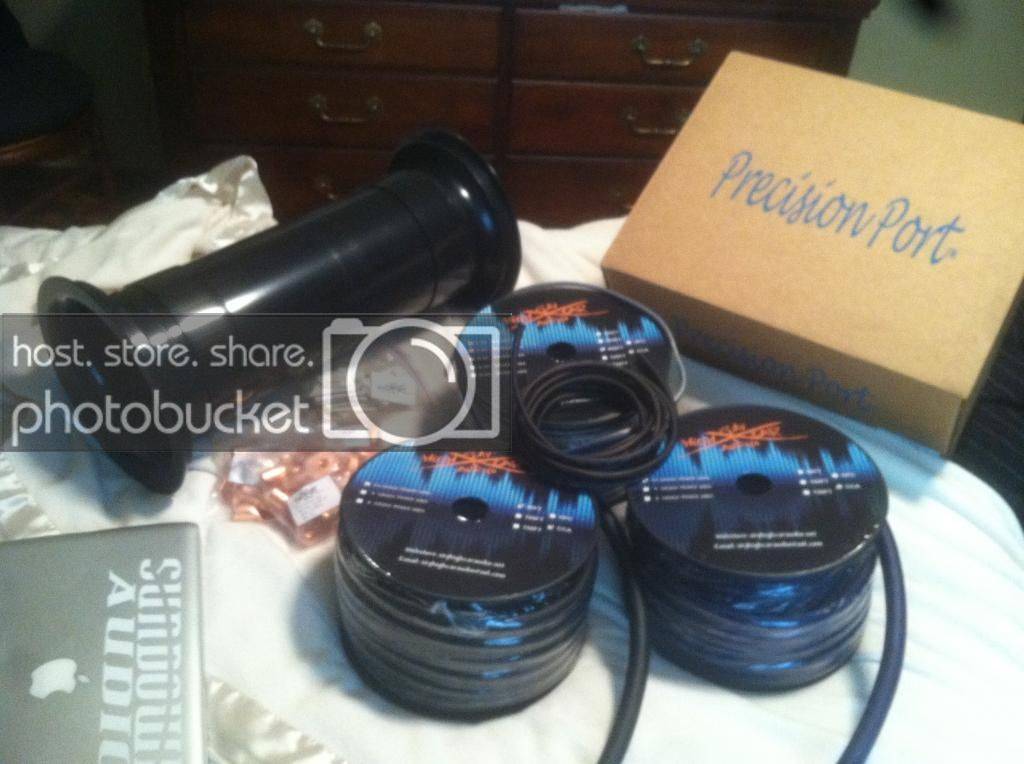

Things started arriving at my door yesterday!
My Pioneer DEH-80PRS

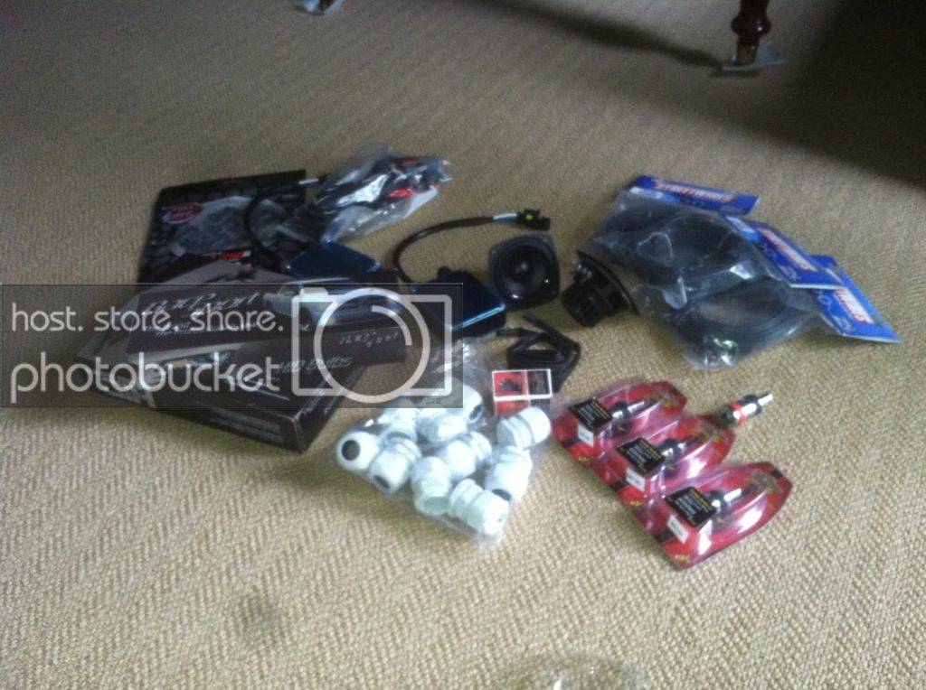

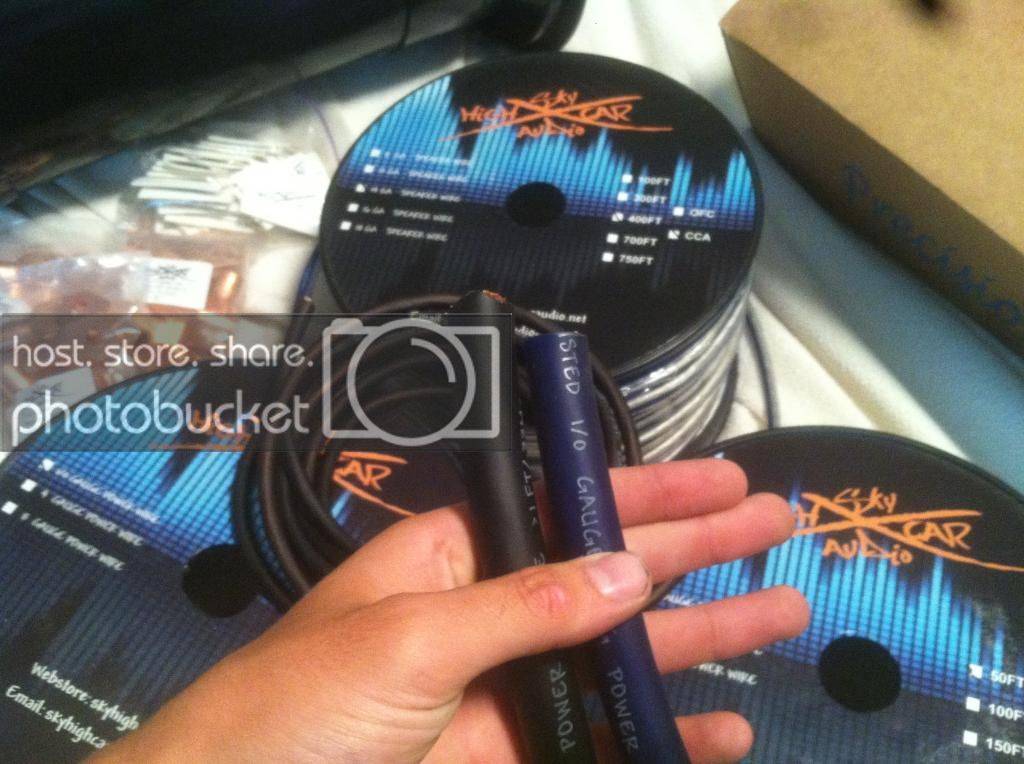

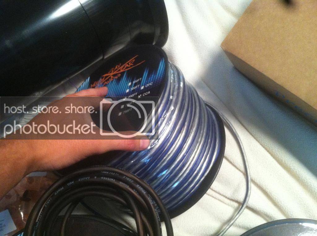

Tang Band W3's, Wire Grommets, Gauge Adapters, G4 HID's for mine that burned out, Fuses, RCA's, Relay, and Heat Shrink. Waiting on 100 feet of Sky High 1/0 and my Mechman 270A Alternator.

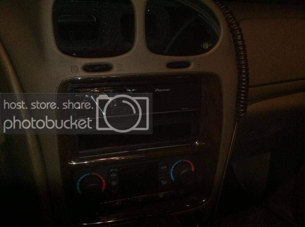

So I popped in the PRS.

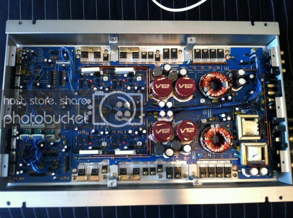

And decided to take a picture of the Alpine MRV-F505 Expert Series 4 Channel I'm using.
AMP GUTS P0RN!

PRS in and new RCA's ran. Left all the old wires for now since I still want to have music during this time, since this is my daily driver.
All wires are zip tied about every 8-14 inches.
No more running through the weather stripping for me. Doing it the right way. Drilled a hole and siliconed the gap. This is for the NeoPro V2 in the door.
I love this picture because it shows the difference between the old and new wire.

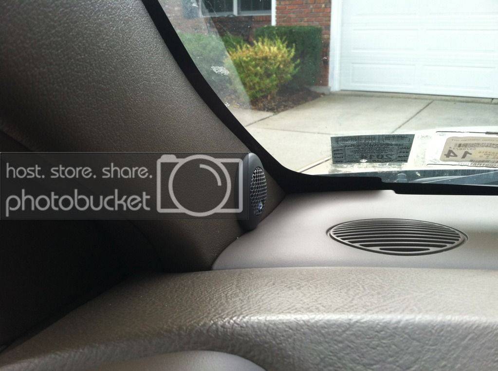

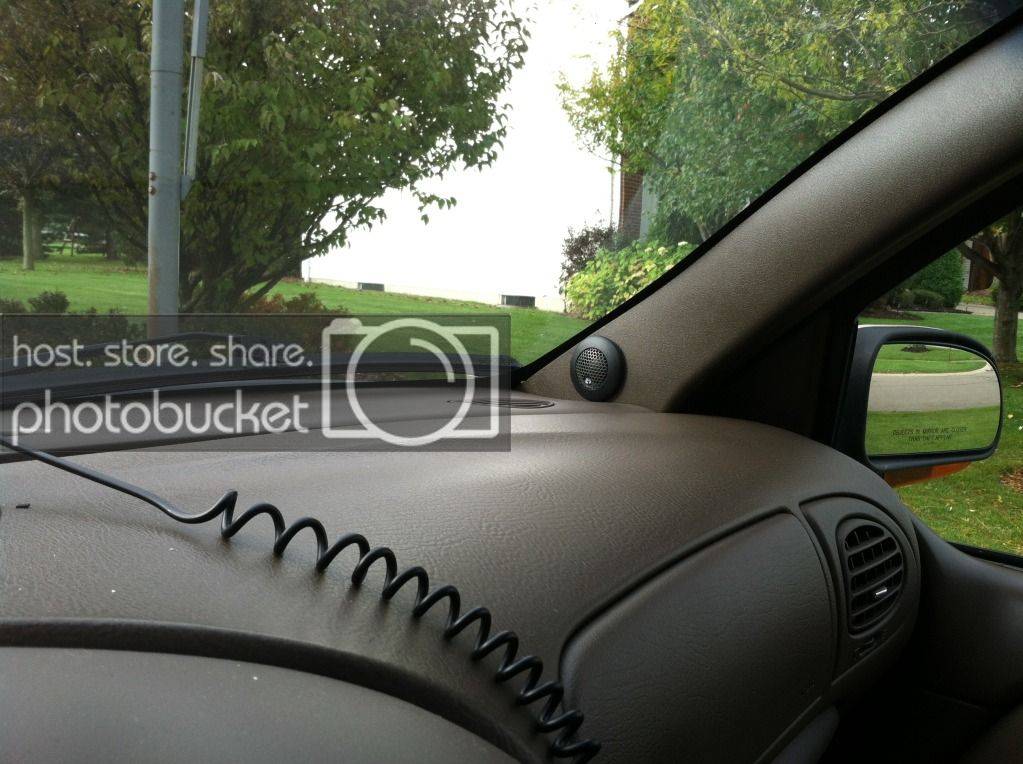

There's the tweeter, just chilling there. The two wires are for the mid and tweeter.

Got some plexi glass over the Alpine Amp. Beautiful guts!

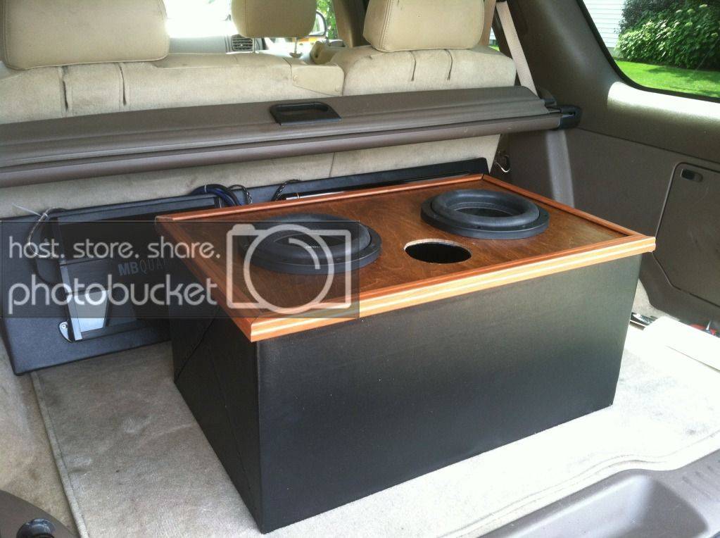

Started the amp rack and put in the bottom piece of the box. I'm going to build the box in the car. The two pieces down first are to make sure the wires aren't pinched. I still have to cut the hole in the middle that the MB Quart amp with be in. They'll all be plexiglass windows, with the two that are already cut, having the two Alpine MRV-F505's showing amp guts. I'm really excited to see how this turns out! Ecstatic with the progress. I've done builds for other people, but have never had the money to do a big build for my own, so I'm thrilled to have had this opportunity to work with my car.
So all in all, I've still got to do the following:
- Build the box, which will be 7.5 cubes at 30Hz with two 6" aeroports, and will consist of bracing on the outside and inside, a recessed double baffle with stained top and black vinyl front which will extend the width of the trunk space.
