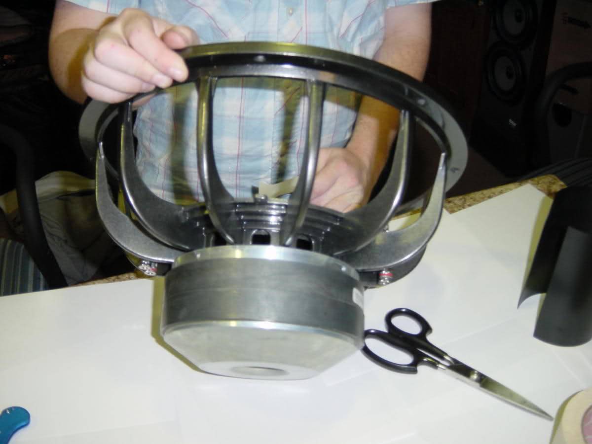

I got my recone in today for the nG Edition 15" Subwoofer.

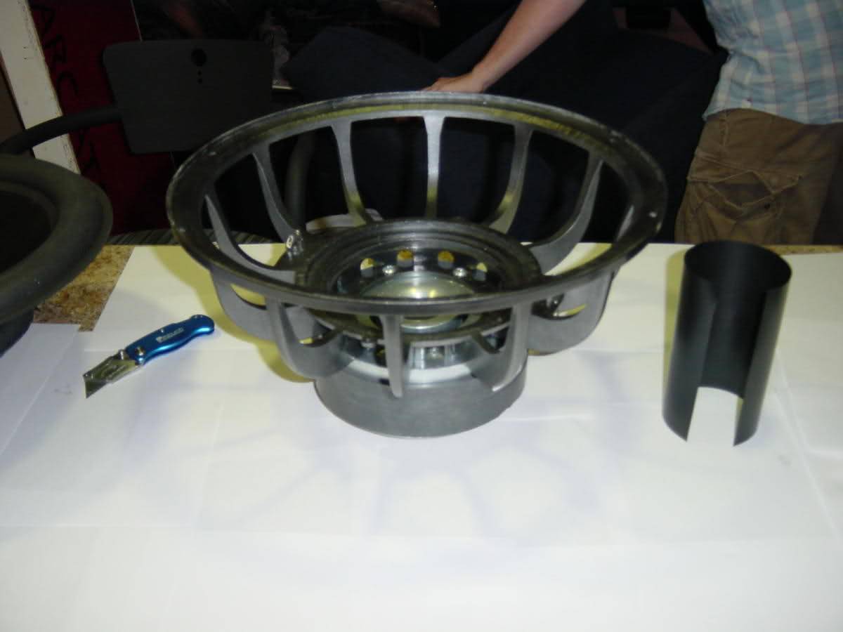

So, I got a motor... and a basket... attatched it to the basket...
Pic:

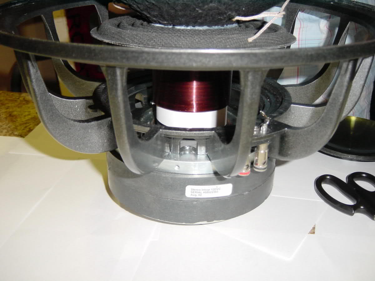

Recone side view:

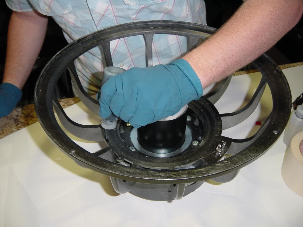

Me WOOFING:

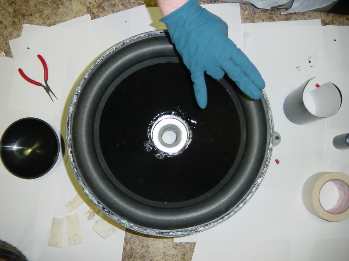

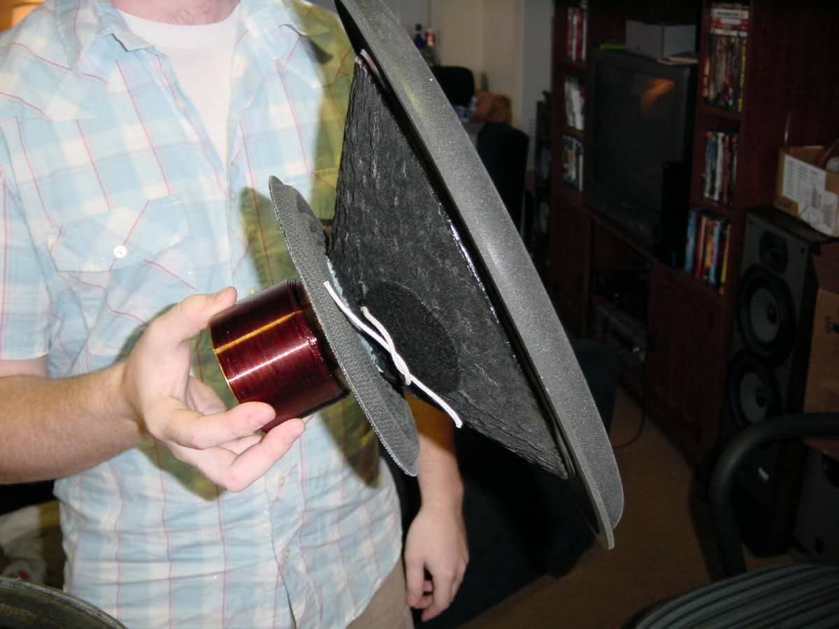

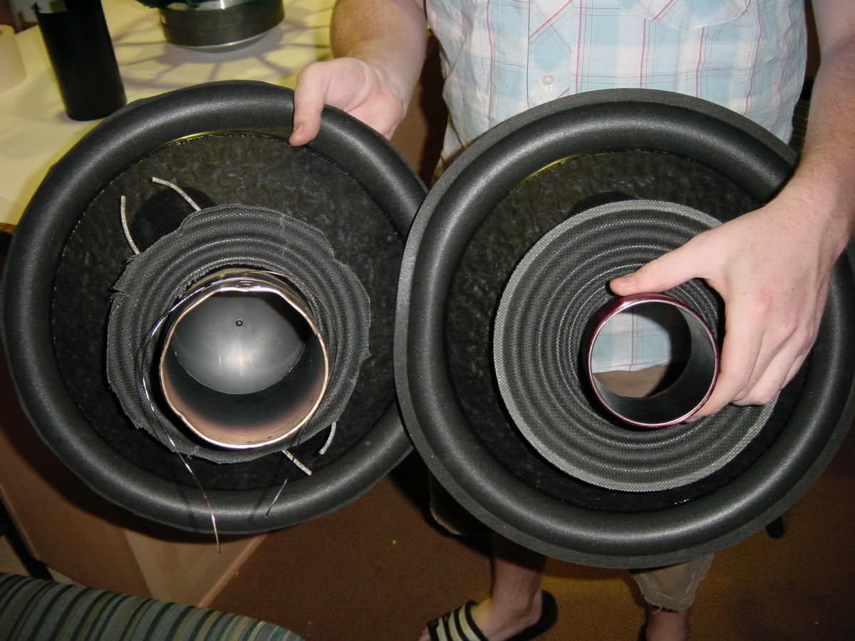

3" and 4" coil comparo:

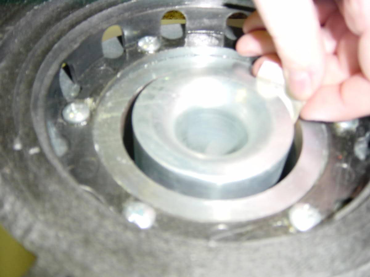

Cleaning the gap:
Gap cap?

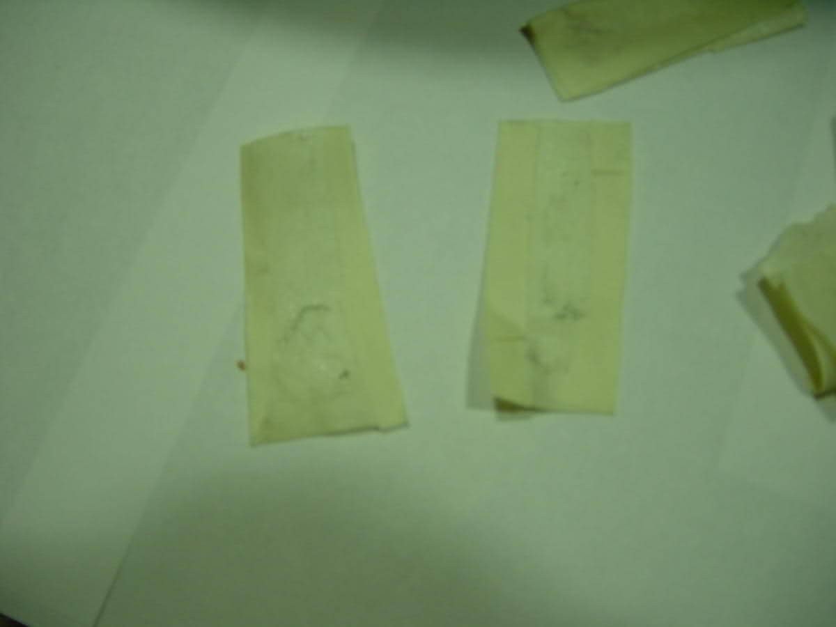

Shims inside the former...
More coming...

that looks like a 15" mag... what is it? only reason i am saying this is because the first year they made the 15" version of the mag was the gen 2's, which had the 12spoke venezulan basket, and the motor structure, magnets, and sticker, are all pretty much identicle to my 12" claw basket. OT: my mag was made by oscar.. ftw

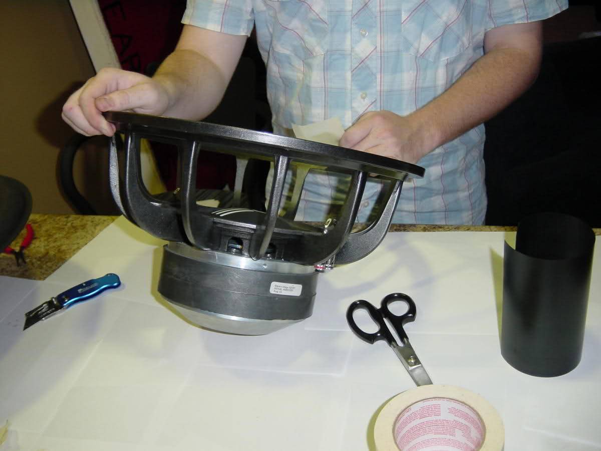

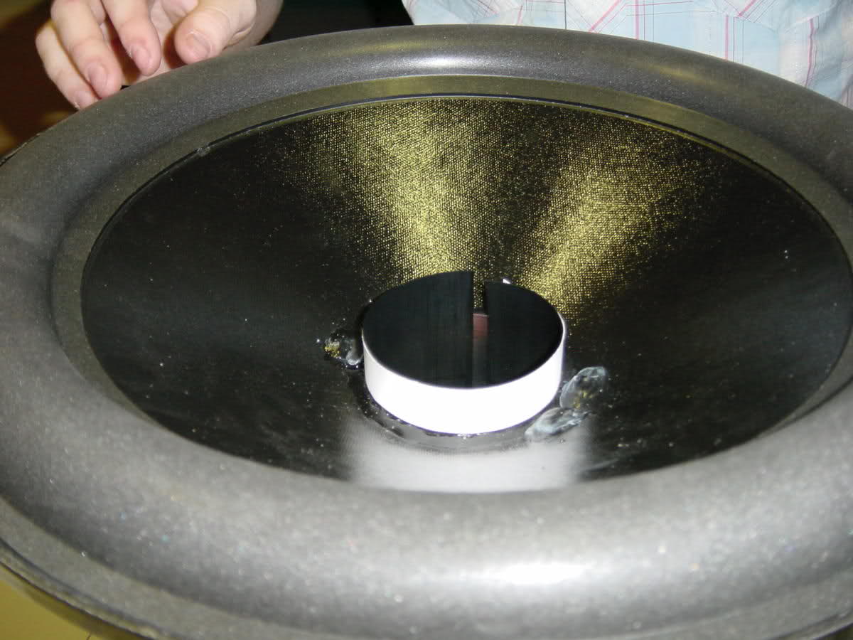

Test fitting the coil with shims in place...

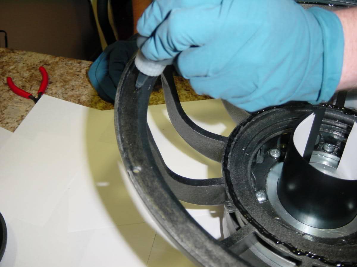

Glueing spider landing:
Glueing surround landing:

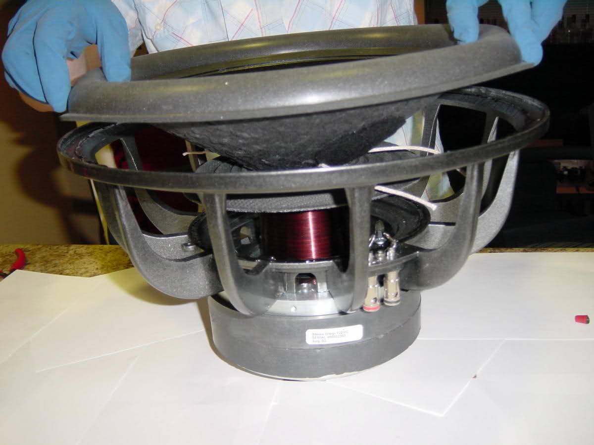

Dropping in the recone:
Perfectly lined up:

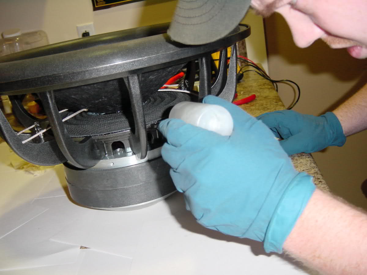

Applying activator to spider landing:
CA to surround landing:

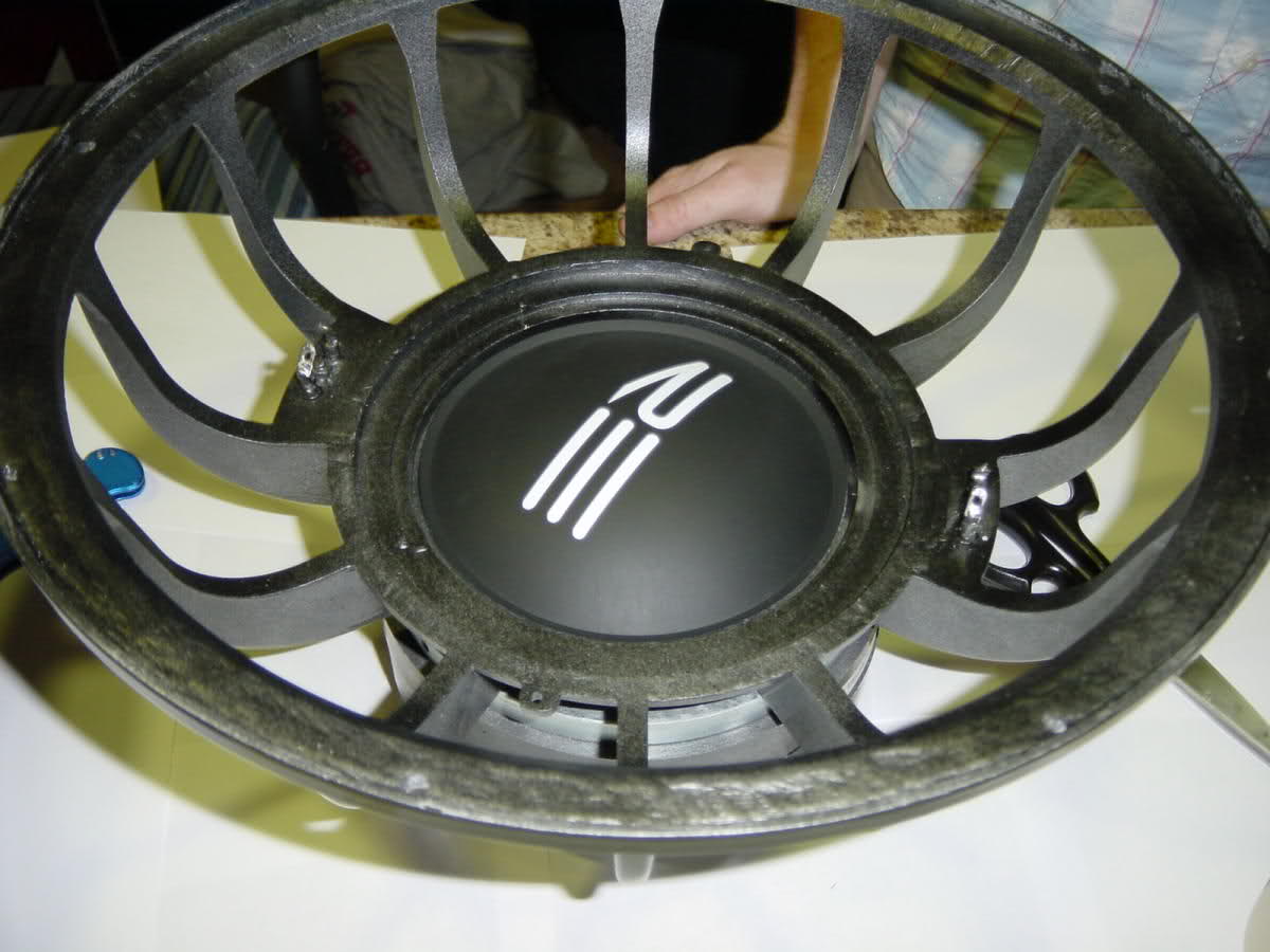

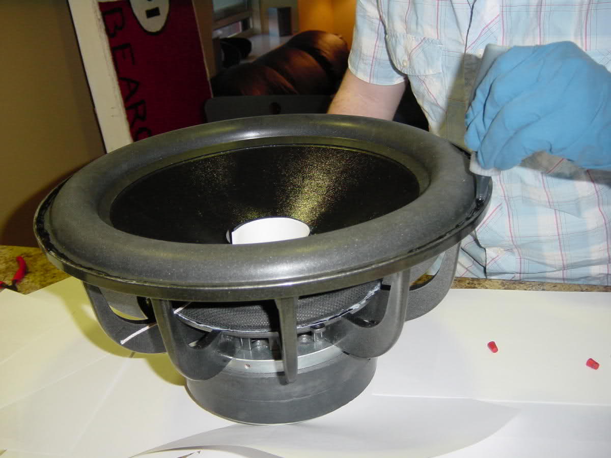

Top View in place:

it's a mag motor yes. but the basket is from my former 15" destroyer. hey noah maybe i'll just order the 18 recone kit and we can perform the one of a kind operation ourselves. hmmm.......//content.invisioncic.com/y282845/emoticons/naughty.gif.94359f346c0f1259df8038d60b41863e.gif
Yeah, It's basically a frankenwoofer...
But I made it //content.invisioncic.com/y282845/emoticons/wink.gif.608e3ea05f1a9f98611af0861652f8fb.gif...
I've had the motor for about a year and a half... then I picked up the 15" basket from the Destroyer 15 we blew up (Thanks DAVE!!!)... and I just received my recone I ordered (Thanks TeamPSIDavid)...
So werd... it's MY woofer //content.invisioncic.com/y282845/emoticons/wink.gif.608e3ea05f1a9f98611af0861652f8fb.gif

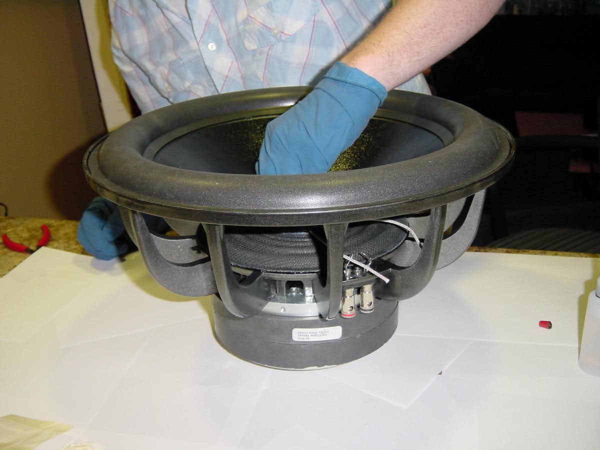

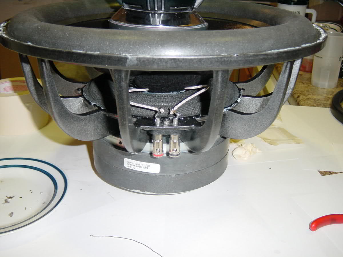

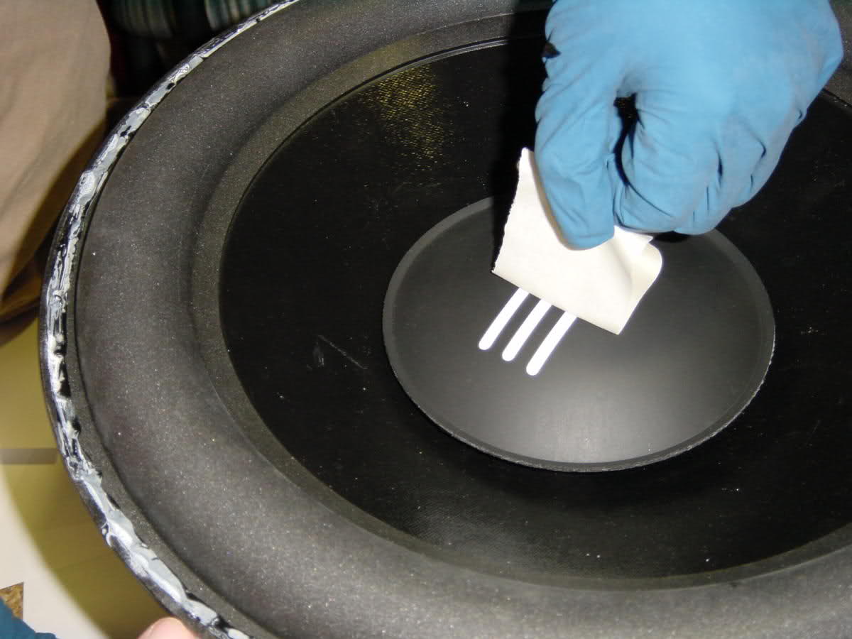

Applying dustcap:
Tinsels in place, XXX6.5 applying pressure to dustcap:

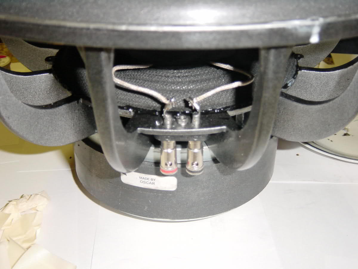

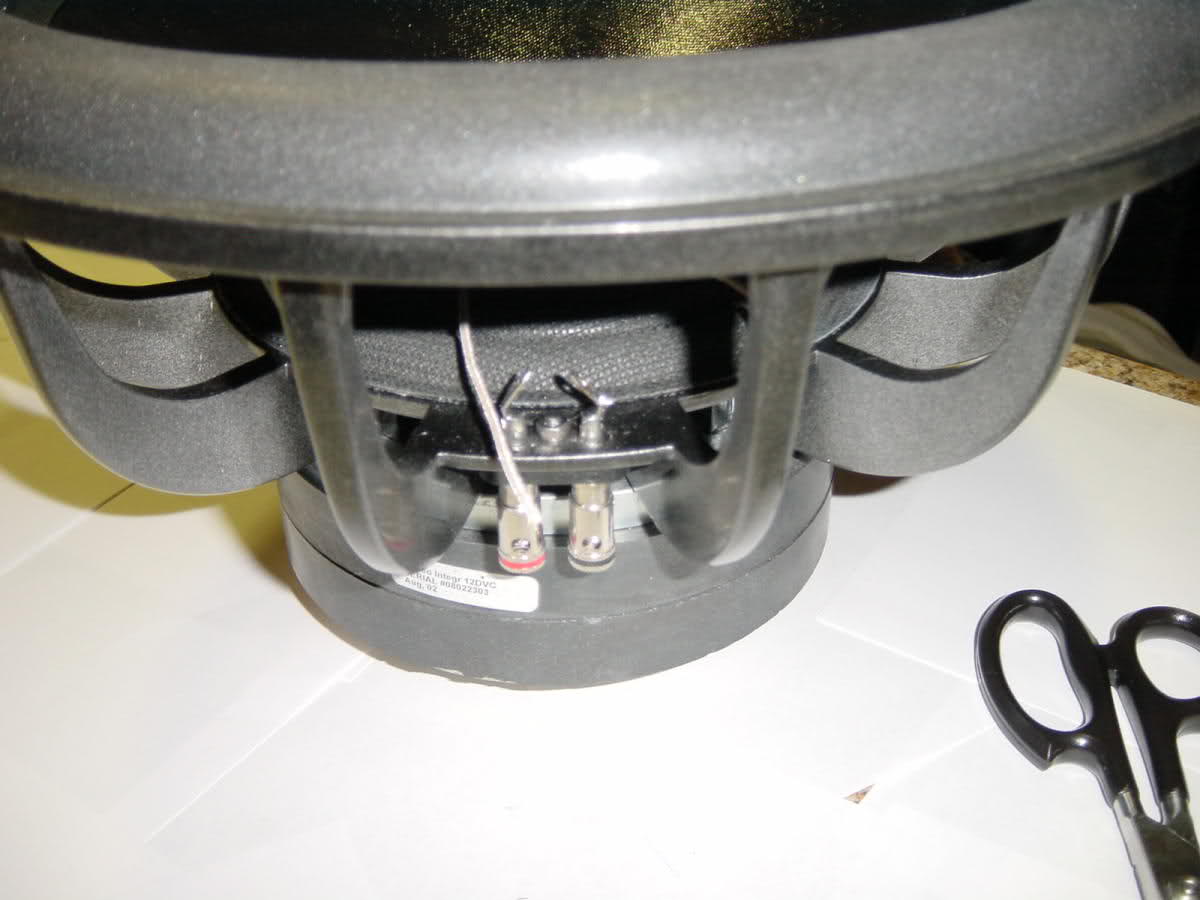

Soldering tinsels:
w00t.
Done, tested on HT receiver free air... works fantastic... no hints of rubbing or mechanical noise.
