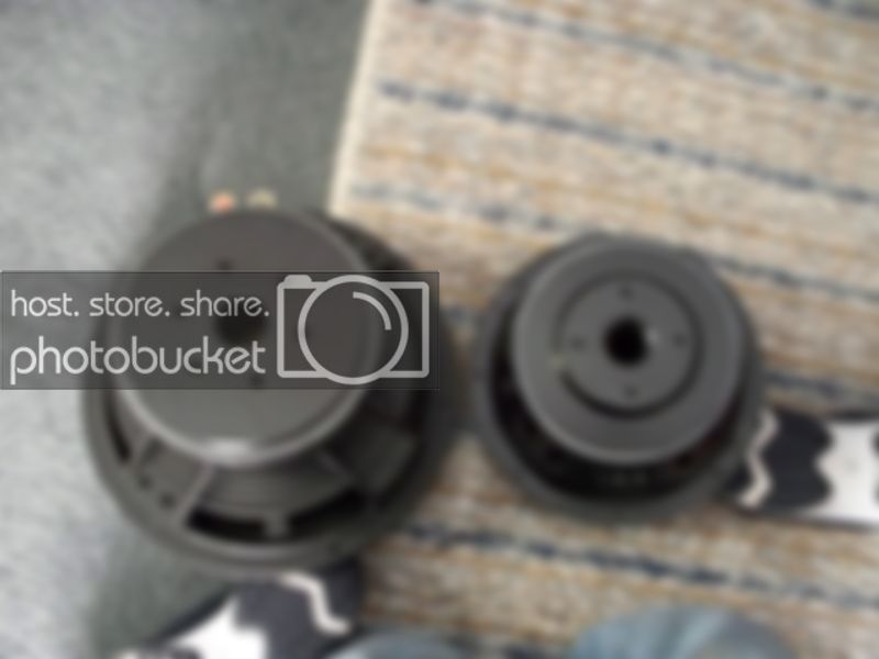

had to downsize from 2 dayton ho 10s ported and 2 cadence txa6004 (25" long each) and go with a little something smaller.
Purchased a Kicker 06ZX700.5 for amp duty and (2) Sundown E8's for subs. decided to run them sealed since the objective was to save space. guess we will see if i can deal with it. lol.

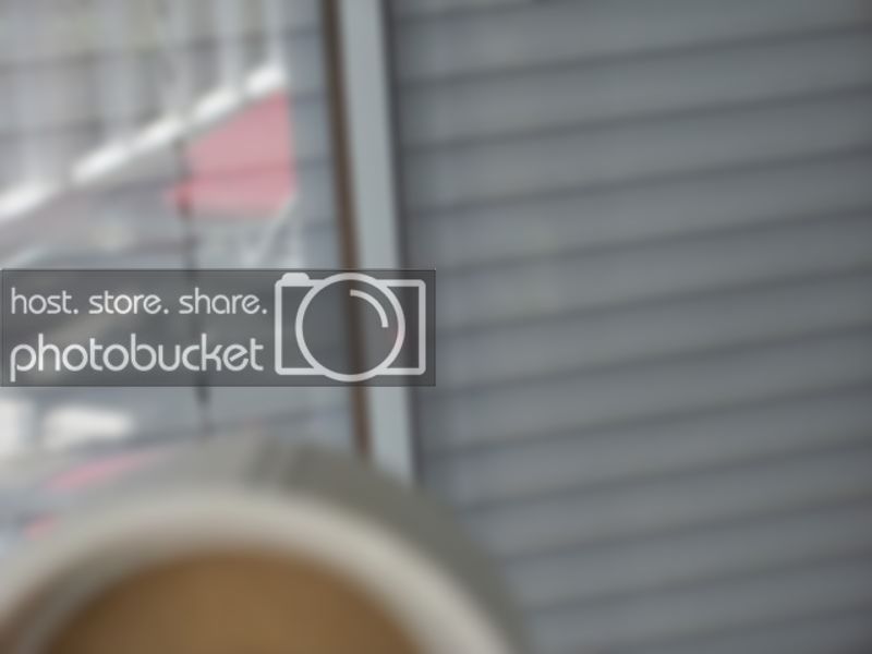

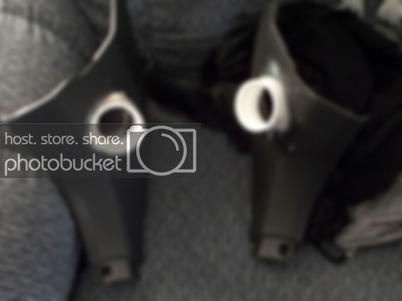

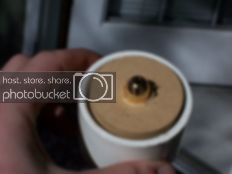

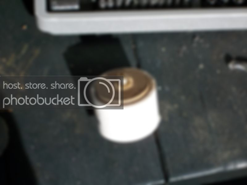

So far, I aimed the tweeters on axis (or close to it). My method wasn't perfect, obviously by the pix, but it's better than I could do just eyeballing it without the laser pointer.
The result? VERY chitty, obviously, but I plan to use some filler and clean it up, no matter how much I filed, i just couldn't get the pvc to slide back far enough to close the gap without chopping off 1/2 of one of the mounting brackets due to the position of the holes previously since the tweeters werent deep and didnt need to slide back liek the pvc. Anyways, there are in there pretty solid for now. as said... ill fix the cosmetics in the following days.

Anyways, here a few pix of the little I got done, and an old pic of the culprit for those who havent seen.
afaik it was pretty centered due to the drill bit in the middle of the circle saw i used, then just drilled it out to fit the laser pointer
well looky there lol

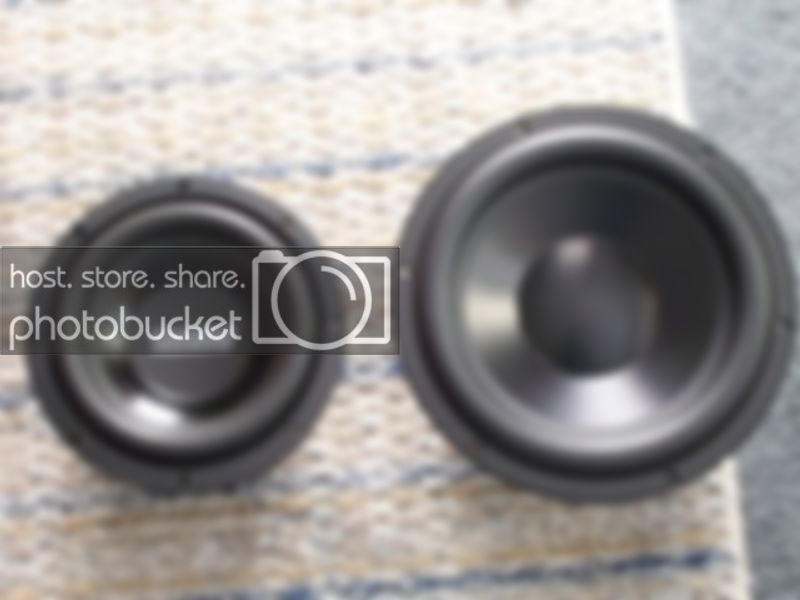

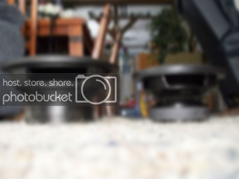

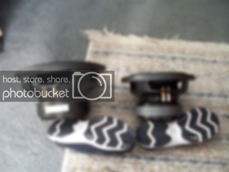

cute lil e8 against the dayton HO
