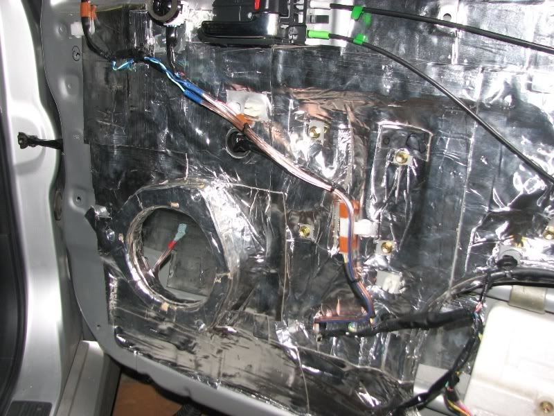

re-wiring door speakers is just time consuming - probably 30 min. each door if everything goes well and you've done doors before. double that for a learning curve. you need to zip tie the new wire to factory wiring every 6-8". have plenty of zip ties on hand.
you can route speaker wiring down each side. speaker wires aren't as sensitive to electrical noise in a car. i usually route RCA cables down the middle, but you won't get noise induced in RCA cables either.
buy a bag of 100 black 6" zip ties at a local autoparts store, walmart, etc. when you route new speaker wires, run them next to the factory wiring bundles. use the zip tie to secure the speaker wire to the wire bundle. trim off the tail on the zip tie when secured.
notice in this pic how the new speaker wire has black zip ties to the factory wiring
