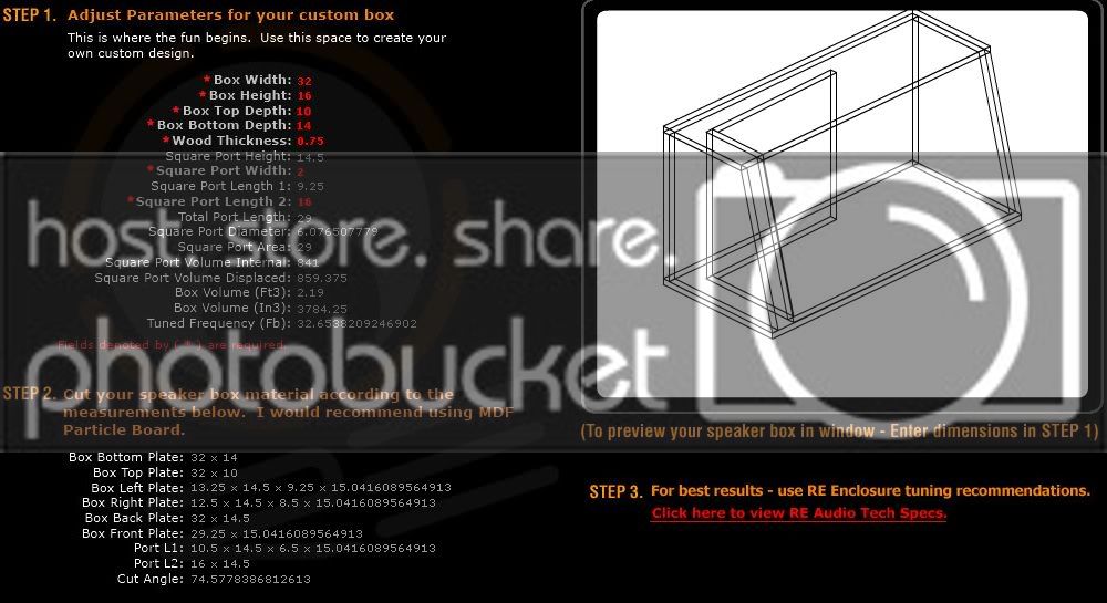

mommyvan im using the plans from the site but I but i NEED my width of the box to be 10" and length to be 32". with that site i cant do it
mom could u please do this for me? i dont think im doin it right. i need 32x10x16(LxWxH)
@ 32hz. minimal requirements for a ported enclosure is 1.5, and i dont think itll even go above that!
I actually may be able to gain more cubic feet. my rear seat is at an angle so i could do this
32" length
10" top depth
14"bottom depth
16" height
heres the pic
the angled port is really weird to construct though.
