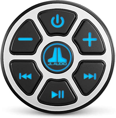

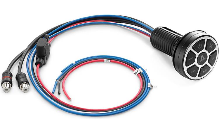

I am just using this JL Audio Blue Tooth Receiver and it has (2) RCA outputs, red and black. I want to run (2) 6x9's and (1) small subwoofer.
If I have (2) RCA outputs what do I need to do to for this speaker configuration?
Thanks,
I've never seen a product like that. Why not just run a bluetooth amp?
