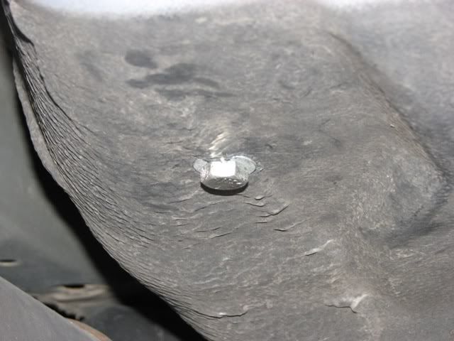

i suspect you have a poor ground connection.
my ground:
You used 14 or 16 gauge wire for power and ground for an amplifier? Is that even possible? I've ran into some undersized wiring on amplifiers, but never 14 or 16 gauge. I'm surprised it would even provide enough voltage for the amp to run for a few seconds. //content.invisioncic.com/y282845/emoticons/crap.gif.7f4dd41e3e9b23fbd170a1ee6f65cecc.gif But as said before, 8 gauge is fine for your amplifier. And again, you most likely have an issue with your ground. Also, make sure you read up on how to properly set your amplifiers gain so you dont toast the subwoofer.
