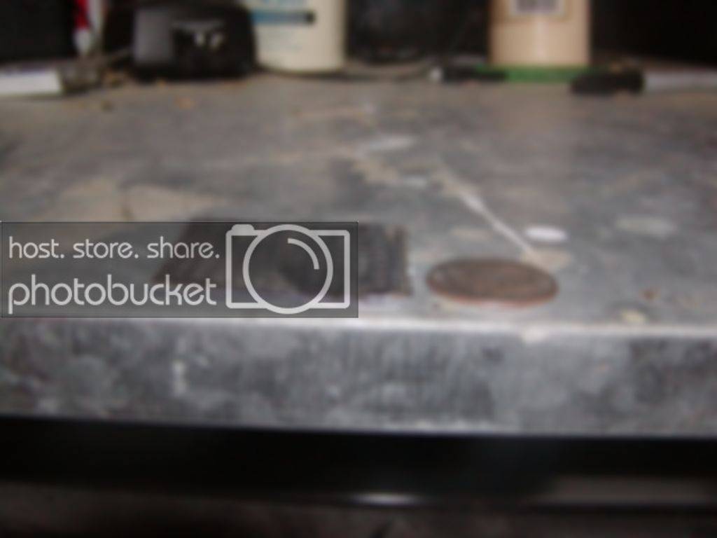

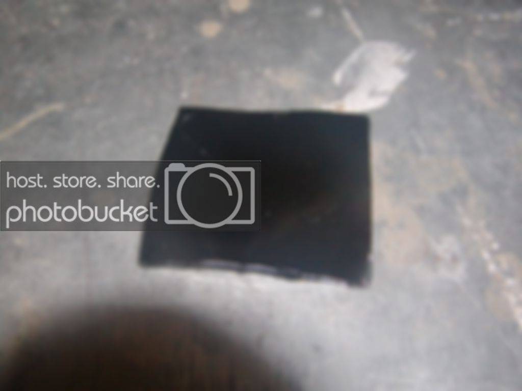

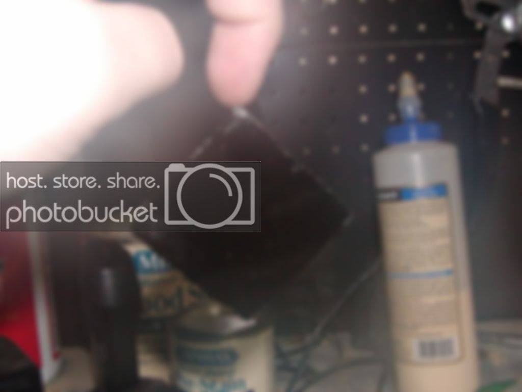

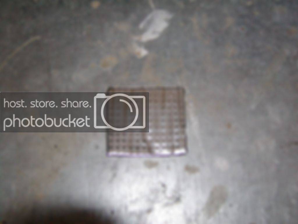

I got this stuff at Home Depot for a whopping $15.99 for a 25' x 6" Roll, or 12.5 SF. My first impression is that it's pretty thin and flimsy. Not much to it really. I assume it's the typical rubberized asphalt material. Once I removed the backing, though, I came to realize that this stuff is frickin STICKY! I know people complain about Peel N Seal coming off... this stuff is so sticky that it would get stuck if I just barely touched it to the metal I was deadening. I doubt falling off will be a problem with this stuff. I did no surface prep, and it stuck with a vengeance.
It did its job well, though. No more rattles from my liftgate. Woot.
Anywho, onto pics:

I don't get it. On the first pics it looks like its just aluminum and on the others its rubber. Or is it just shiny? I Need to deaden so I might go buy some but is that solid enough even be worth it?

That's the two sides.... the aluminum is the outside, and the black is the sticky side...
