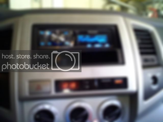

Project "Son" **PICS**
its in and next time i c him will get good shots of everything... for now Camera phone FTMFL!
i really like the HU thou! $150, wire harness dash kit included free shipping....cant beat it!
where!?
forgot to updat! sub is broken in etc.... speakers sound amazing... no voltage drops due to me putting in a batcap 2000... really great sounding system!
edit: also had to fix the rca grounding..... **** pioneer! //content.invisioncic.com/y282845/emoticons/laugh.gif.48439b2acf2cfca21620f01e7f77d1e4.gif
If you want to, see if you can find the 130 amp alternator from the Tow Package tacoma's. I have one in mine (mine came with tow package) and even beatin away (i'm still under 1kw) lowest i've seen at idle on a hot alt was like 13.2
On a cold alt slammin I've seen it stay up around 13.8
Good looking install, I like that sub/amp rack
Could the doors been sealed up a bit better to increase midbass? I also agree with the last poster about the cables going over the side should be drilled down into the box. Including the RCA cable that goes up and over the box from the amp. It all looks good though. Nice install.
