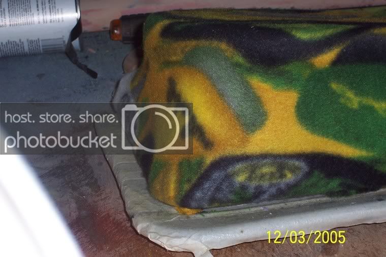

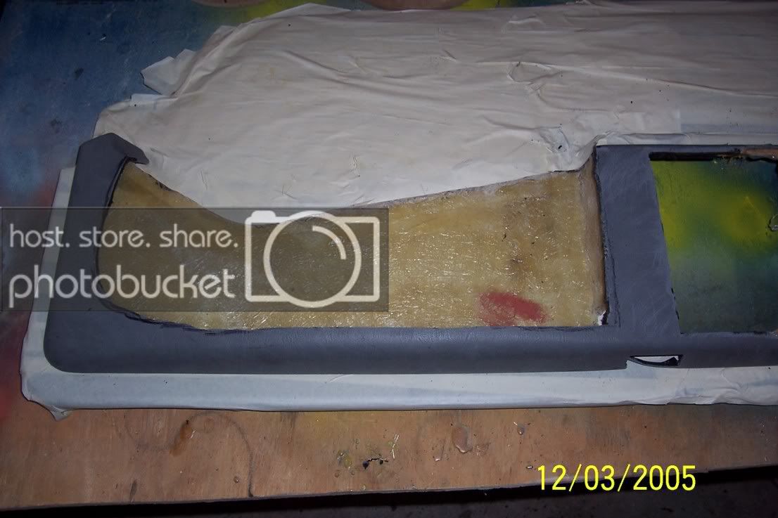

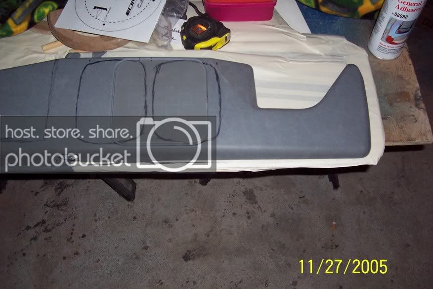

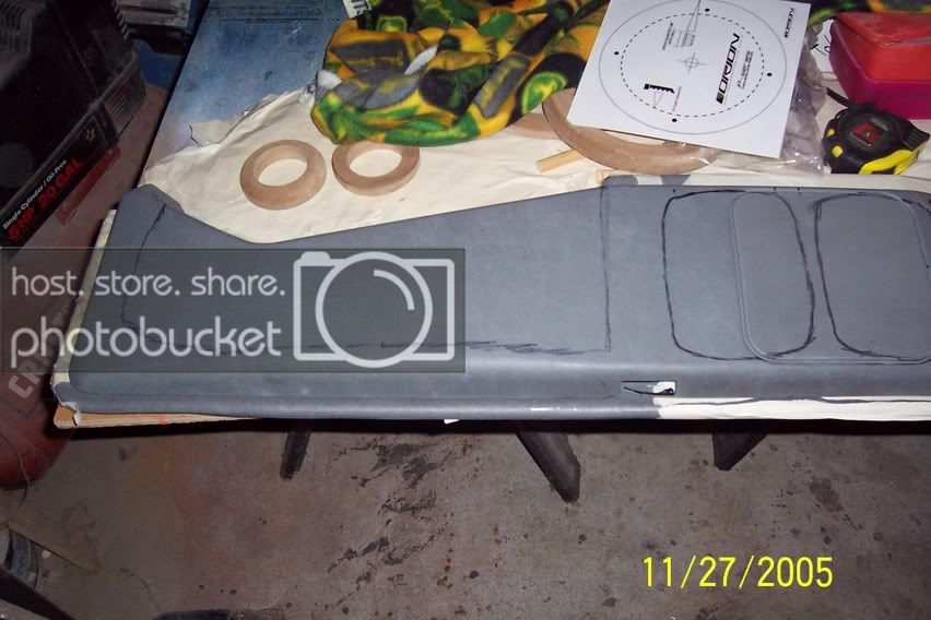

Well here's where we are currently. Still got lots of filler work to do, but it's a start.
Started with this
index.php
index.php
index.php

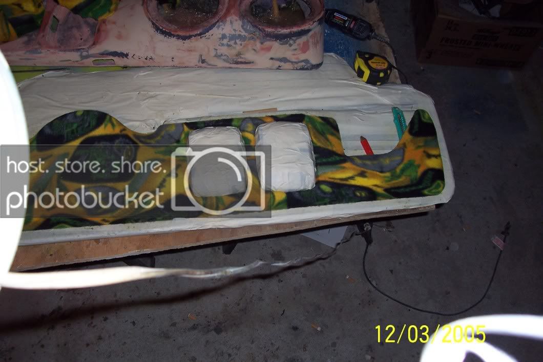

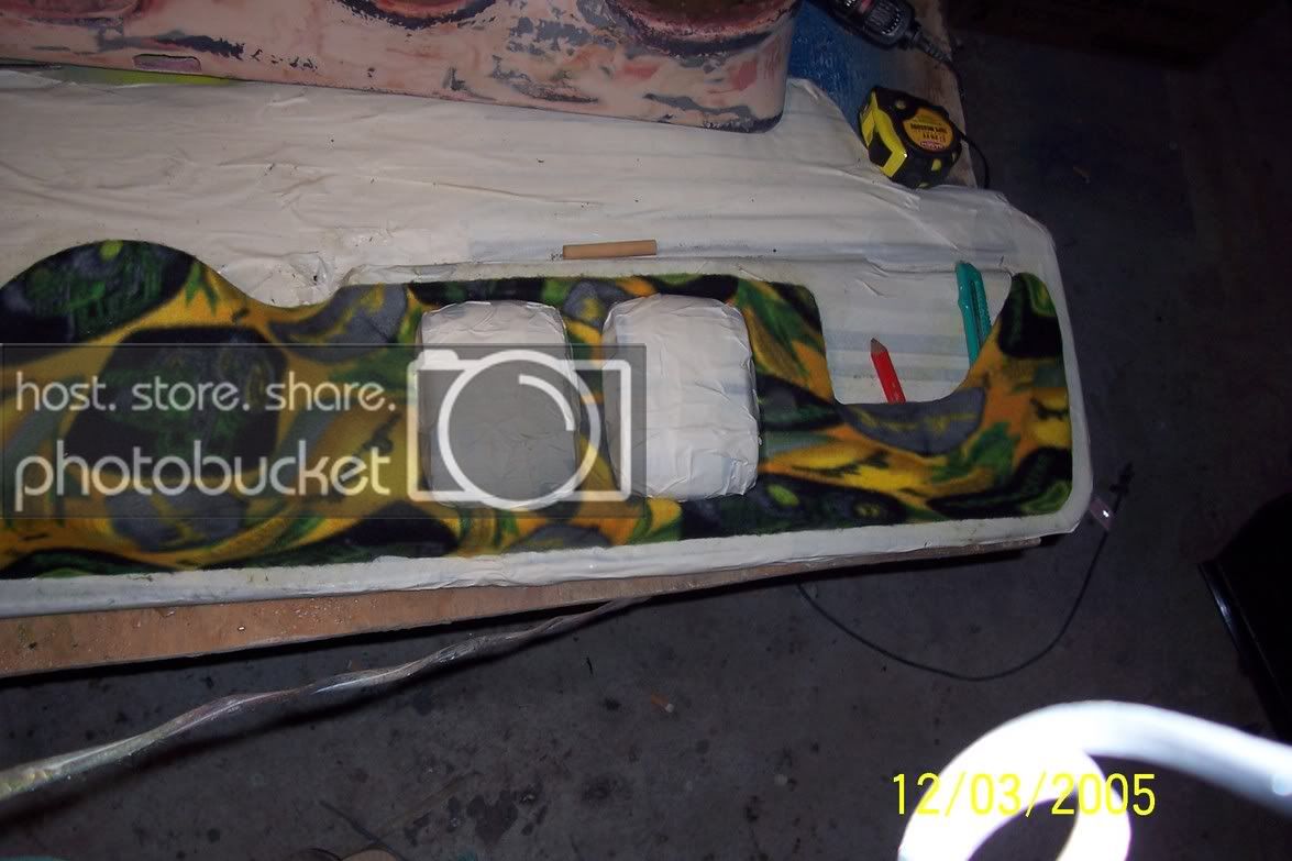

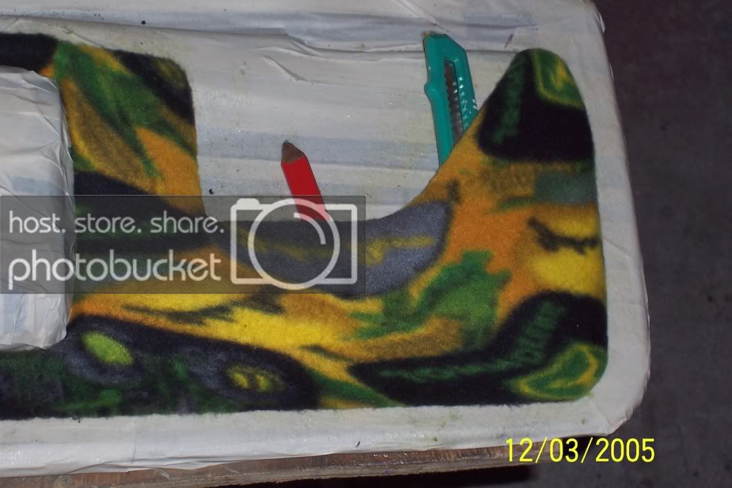

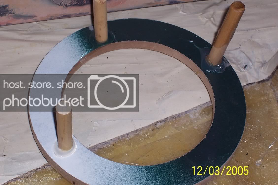

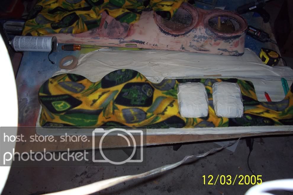

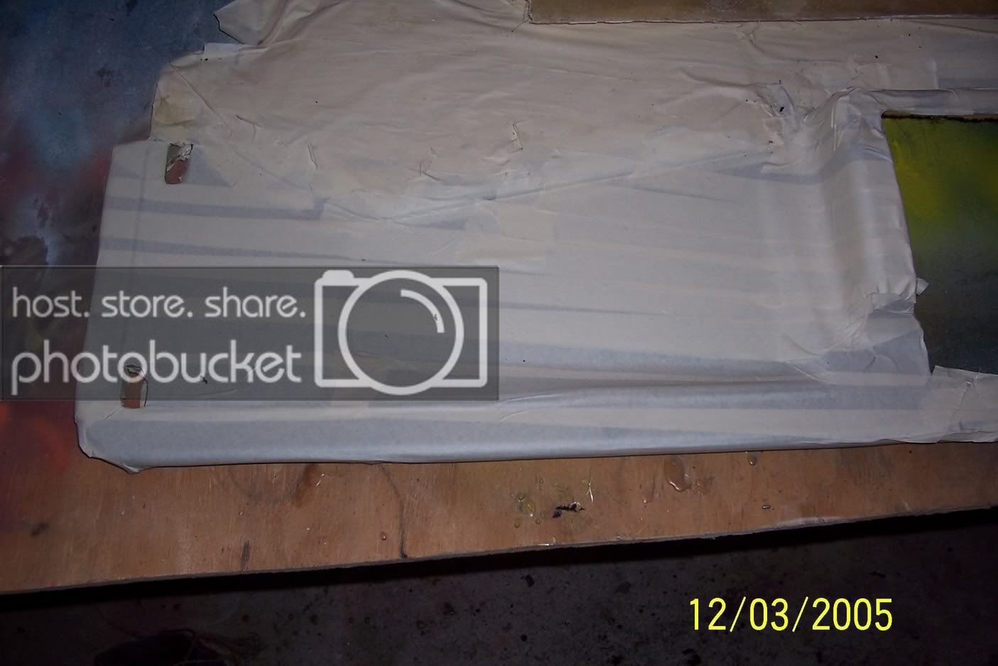

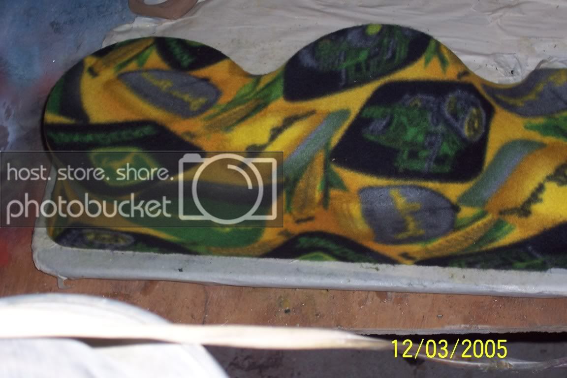

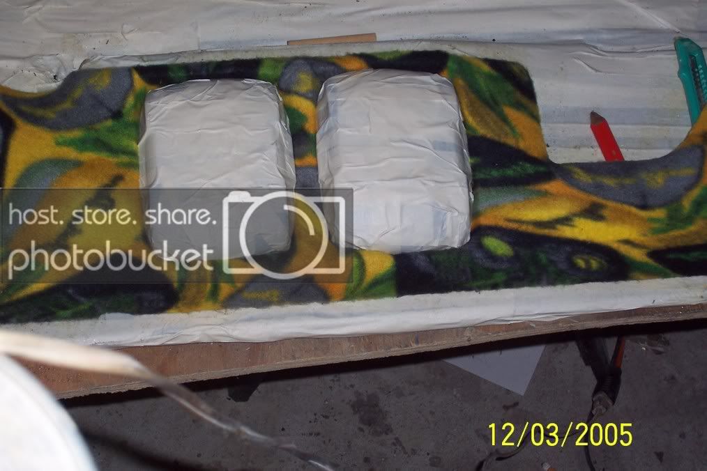

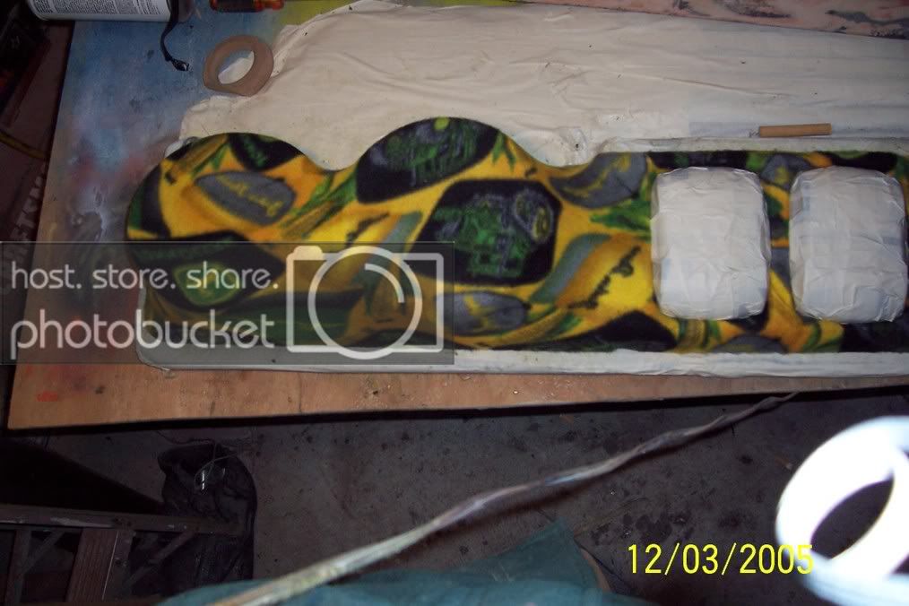

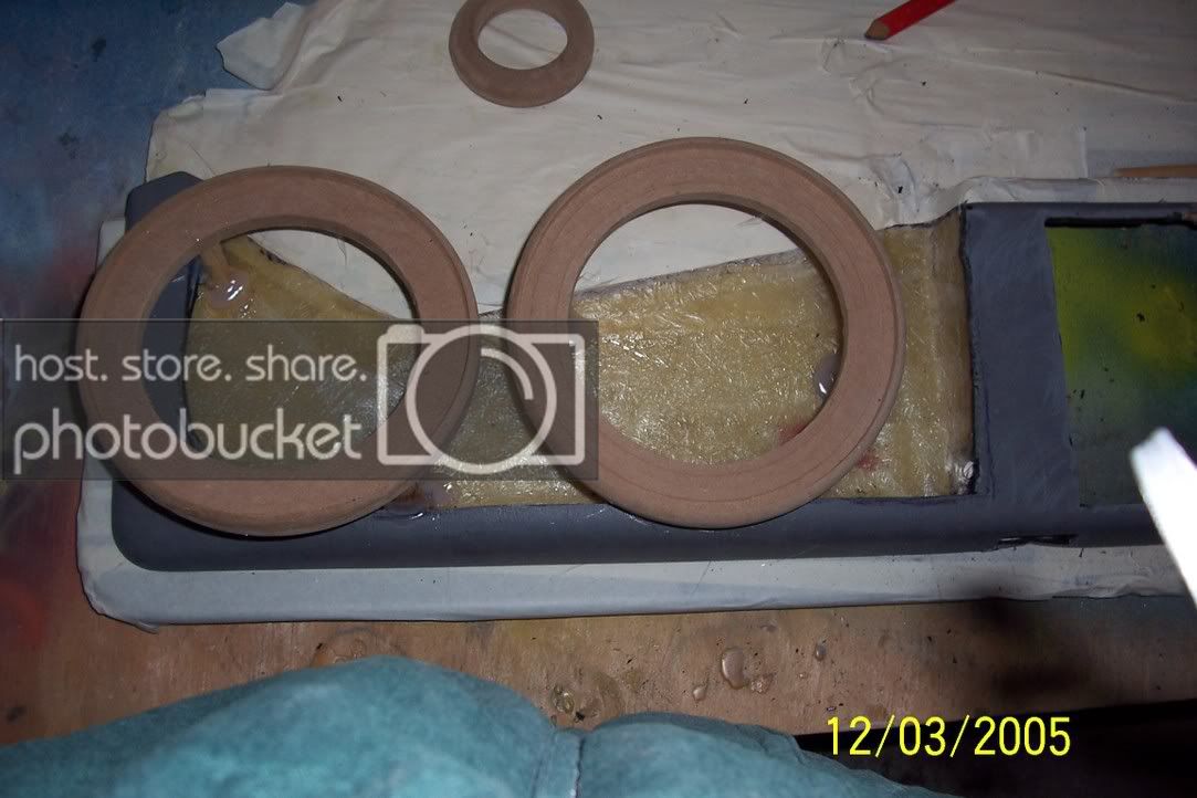

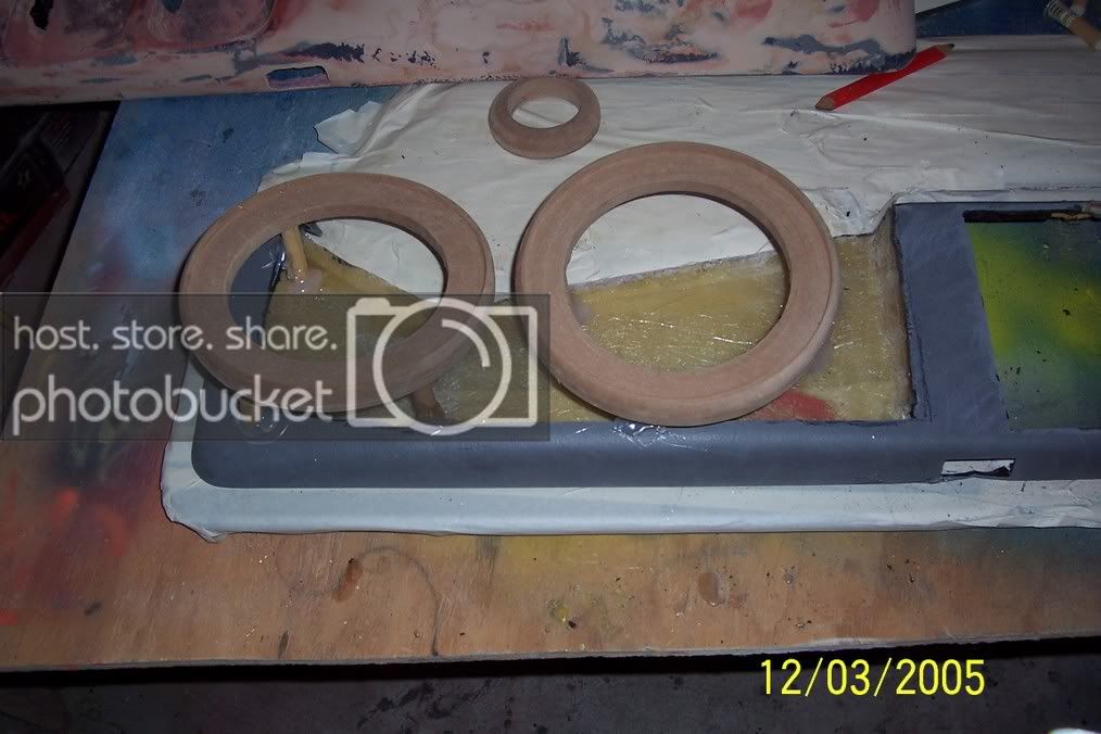

Add some rings, fleece, fiberglassmat, some resin, and one coat of filler and we get to here
index.php
index.php
index.php

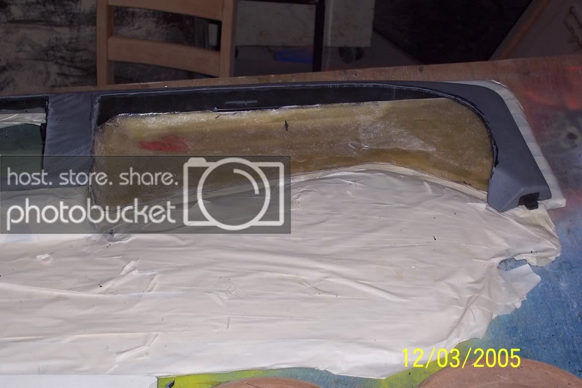

Lots of smoothing out still to do. //content.invisioncic.com/y282845/emoticons/smile.gif.1ebc41e1811405b213edfc4622c41e27.gif
how is that for imaging? having the tweeters mounting in the top like that
I'm more concerned with the number of drivers period. I tried to get the tweets as close together as possible. This was the only way I could get them remotely close together. The tweets can be swiveled ( sp?) in their mounting cups to help with imaging. //content.invisioncic.com/y282845/emoticons/smile.gif.1ebc41e1811405b213edfc4622c41e27.gif

Well that's as far as I got for the day. More to come later //content.invisioncic.com/y282845/emoticons/smile.gif.1ebc41e1811405b213edfc4622c41e27.gif
good stuff mr ramos //content.invisioncic.com/y282845/emoticons/smile.gif.1ebc41e1811405b213edfc4622c41e27.gif
i dont like glassing to plastic though //content.invisioncic.com/y282845/emoticons/frown.gif.a3531fa0534503350665a1e957861287.gif
me either, it doesn't stick at all. So I drilled little holes every inch or so along the edge to give the resin some teeth so to speak //content.invisioncic.com/y282845/emoticons/smile.gif.1ebc41e1811405b213edfc4622c41e27.gif
keep us posted man...it looks great so far...what's goin in the doors btw?
A full set ( 2 6.5's, 2 tweets, and two crossovers ) of orion p-series components in each door. //content.invisioncic.com/y282845/emoticons/smile.gif.1ebc41e1811405b213edfc4622c41e27.gif
