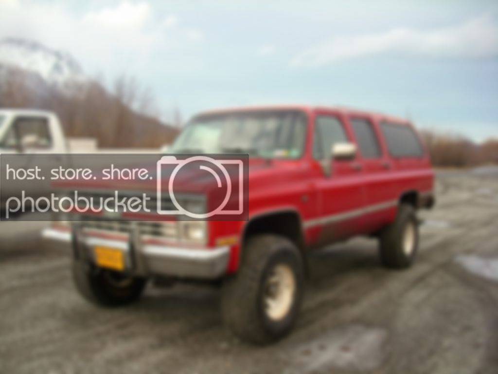

My vehicle of choice will be my trusty ole 1987 Suburban with a 4" Rancho suspension lift sitting on 35x12.50x16.5 BFG ATs which I off road on a regular basis.

The truck I will be using for this build...
