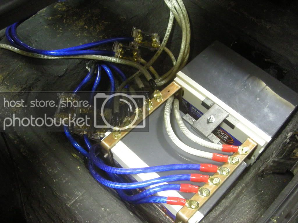

You have to get kind of creative. multiple runs front to back isn't a bad idea and have busbars to handle everything makes things easy and simply better

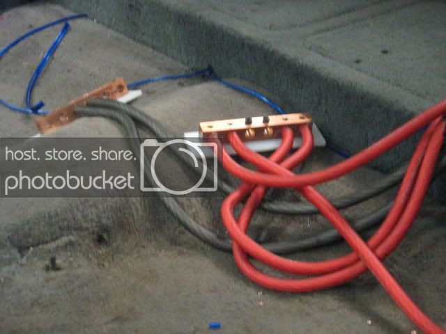

This is the 4 runs of power and 4 runs of ground 1/0 I have running front to back and how it's all connected in the rear to the 2 D3100's (.25" thick x 1.25" wide copper bar connecting them, with tapped holes across it for connection points)

haha i'm picky like that too I prolly would of waited and ordered more blue LOL none the less its hidden under box anyways. Nice job tho thats the best way and how most people wire and run multiple wires to batts.

Yea, right now the busbars and batts are in plain site though with this setup...it still doesnt look horrible but down the road they'll be fairly covered by more stuff going in the trunk //content.invisioncic.com/y282845/emoticons/wink.gif.608e3ea05f1a9f98611af0861652f8fb.gif
Nice, nice. My mind says to use thicker busbars, but that's just me. Sexy though.
For future reference, when making a low inductance pulse based system (we're talking
I made a distro block in my other system that was a 1.25"x1.25"x6" copper bar, drilled holes on one face for the wire connection, and drilled a smaller hole perpendicular to it on another face to make a setscrew distribution block style thing. By far the best connection style you can find. I believe I used .53" for the main holes, and whatever the size is for 5/16"-18 bolts for the set screw.
Probably not, those look like 1"X1/4" buss. The rule of thumb is 1000A/square inch of buss cross sectional area. 250Amp max if that is indeed their size.
not according to all of the charts i have seen, I did miss label by putting continuous on the last post . but the manufacturer that makes this copper alloy says on there chart that this size copper will only incur a 30*C rise from 560 amps and in car audio since the power is never continuous it can take even more then that.
