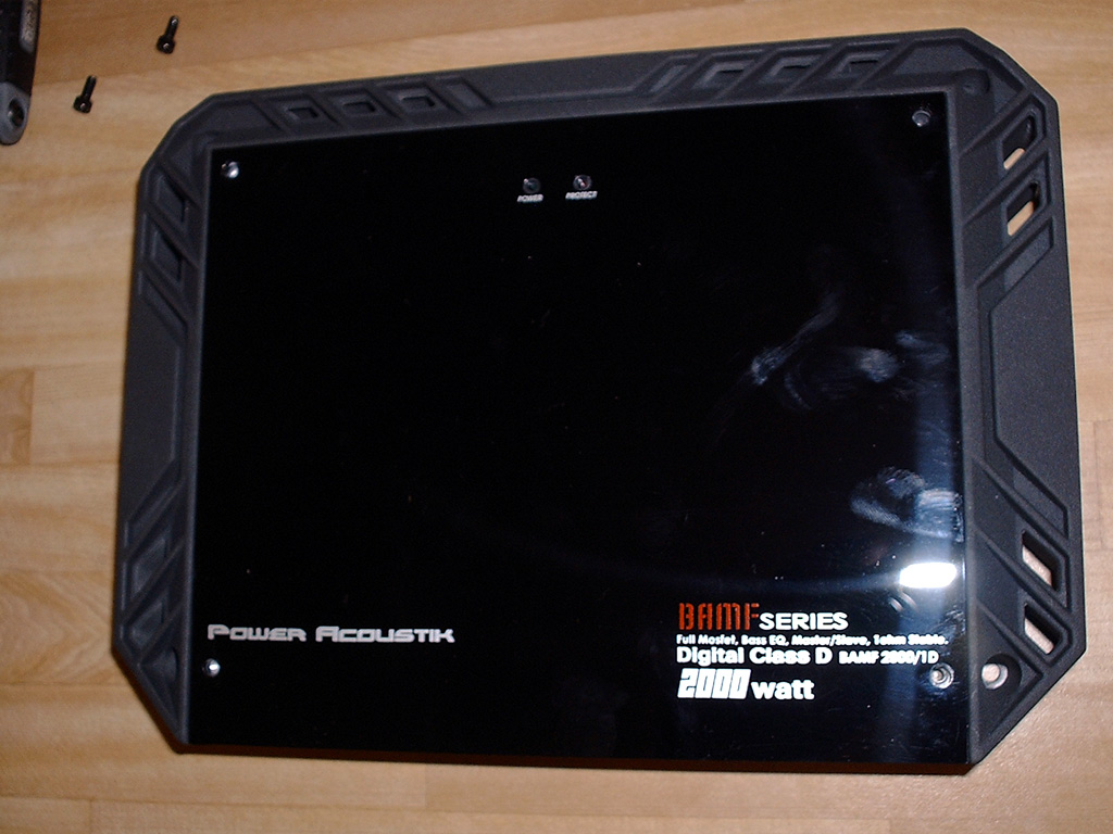

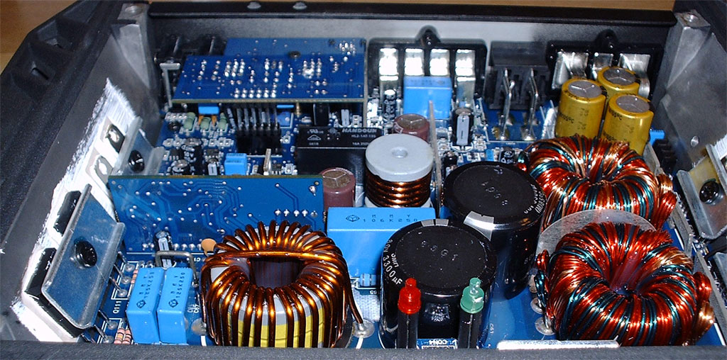

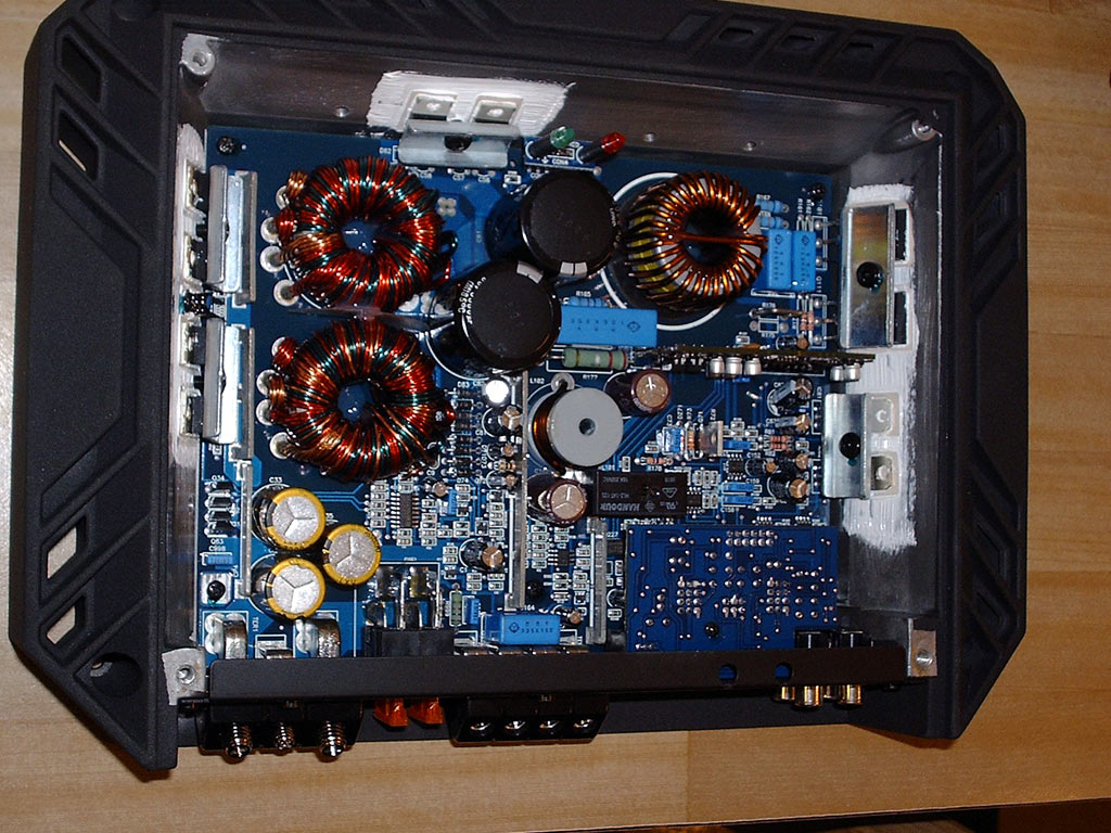

If I had to judge by the way this amp is built, I'd put PA above those brands. They claim this one will do 900x1@2ohms RMS. I only need 700, so if it's overrated then that's fine with me and it was still a good deal at $160. The set-screw terminals look like they have cheap plating on them, but everything else seems to be quality.
I don't know that I would buy this line for my front stage (I have a JL e6450 now) but for a sub amp, it will be fine as long as it doesn't burn up.
Yep - layout looks solid. I think if a company like RF or kicker put that in an amp and called it 800w for $200 everyone would think it's great. It certainly looks good on the inside.

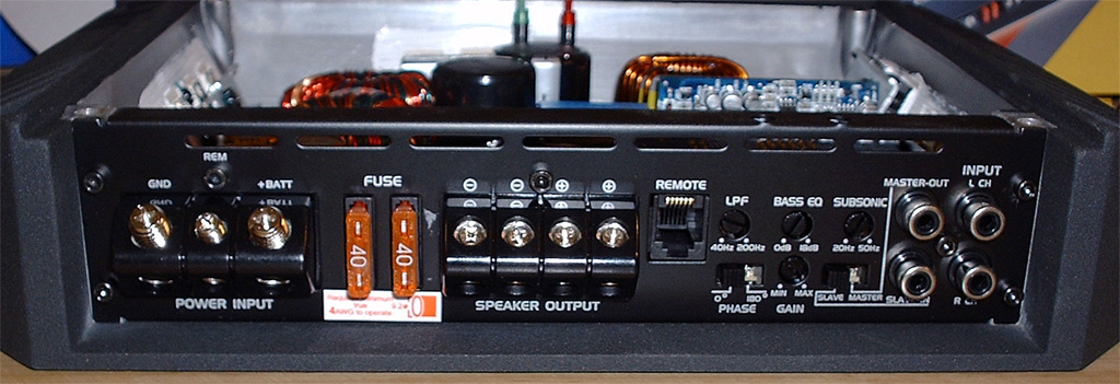

lets just say my ov1-4000d only has 120 amps of fusing on it...thats1440 at 12v
1560 at 13v
1680 at 14v
that is the absolute most the amp could ever put out...any more and the fuses would blow
It's really not that black and white. For one - you haven't accounted for efficiency. For another - fuses aren't light switches - 30A fuse doesn't just blow the instant 30.1A tries to flow through it. With a dynamic current demand such as an audio amplifier a fuse that size could pass 40, 50, even 60A on bursts w/o blowing. That's not to say the amp is accurately rated, just that using fuses to determine absolute optimal power output is a LONG way from accurate.
i said that was the absolute most it could ever put out...i never said you would see those numbers...and i could see a fuse taking 5 amps over the rating but that just accounts for manufacturing flaws...most fuses...if any...will take double what they are rated for...while yes they will take considerably more than their rating for a split second but no longer than that
but that's not accurate, at least not based solely on fuse size.
If you look at a time constant chart for ATC fuses - http://bussmann.com/SearchResults.aspx?search=atc+data&type=Omni
You'll see a 40A ATC is designed to pass 70A for about >15 sec before melting (average).
A 30A ATC will pass 50A for about 20 sec.
You can only get a rough estimate from the size of the fuses. There's know way to know whether the designer intended them as a form of protection against stress (blowing at the first sign of trouble) or protection from catstrophic failure (blowing just before the amp catches fire).
You might be right that your amp can't do 1700w, but it could well do 1800 or 1900 if you're just looking at the fuses.
