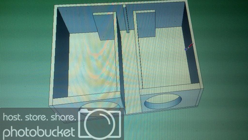

I am designing a box for my two Tantric Hd 10s. i was told by Murphy i should give each sub 1.5 cu ft net (seems kind of big but he made the subs lol), with 12-13 port in per foot tuned between 30-33. i literally only have a 26 inch opening between by cabing and my trunk so i am limited in my port designs and sub placement. this will be a forward firing sealed trunk (wall). will this style of box cause me subwoofer loading issues or has anyone used this style?
sorry about the photo, i had to use my phone to take a picture as i cant upload google sketchup here
