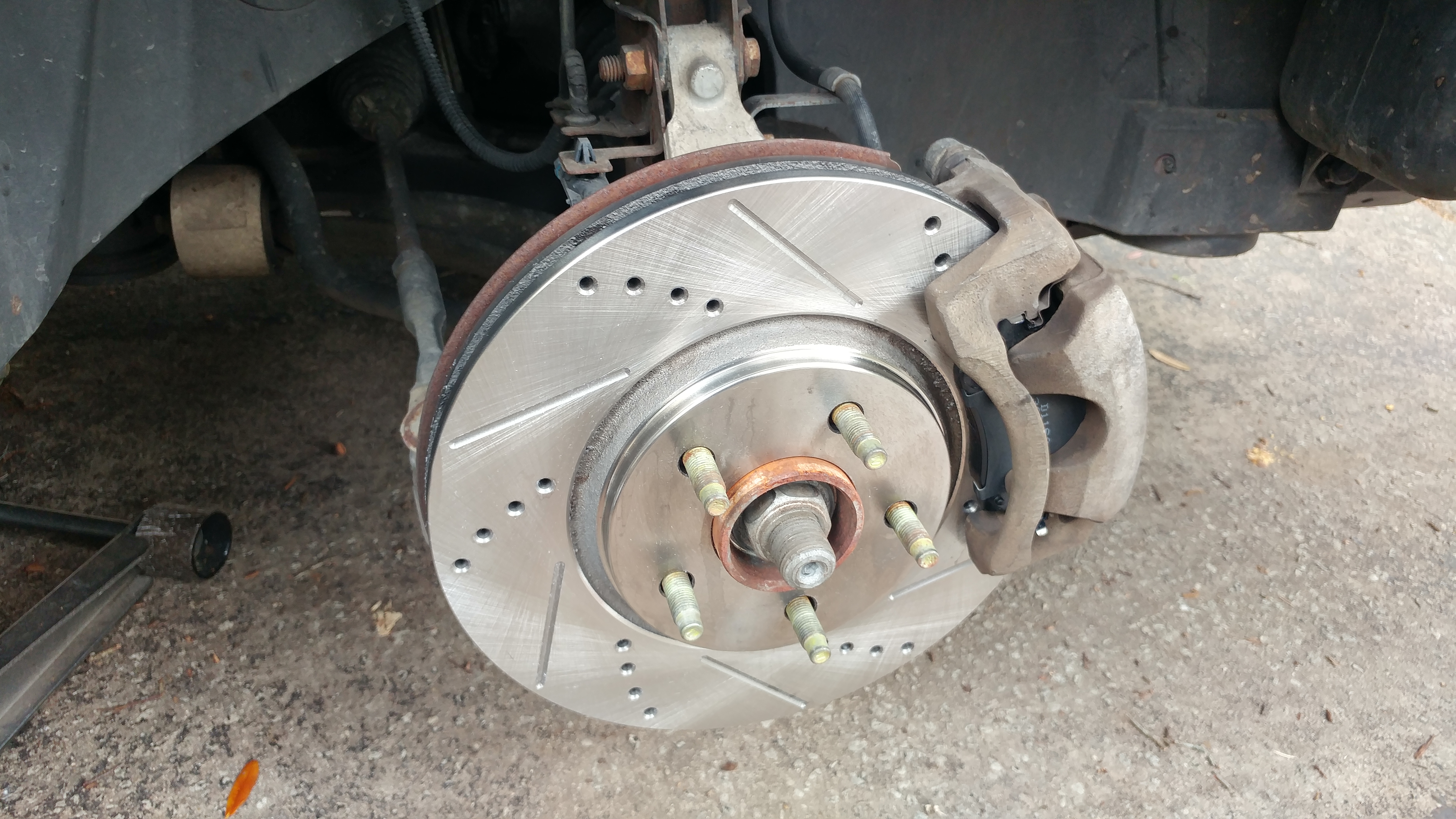

Cross drilled and slotted rotors on a daily driver is pointless. They are more prone to cracking and have less surface area. Only time you need them is when racing and experiencing brake fade from too much heat.

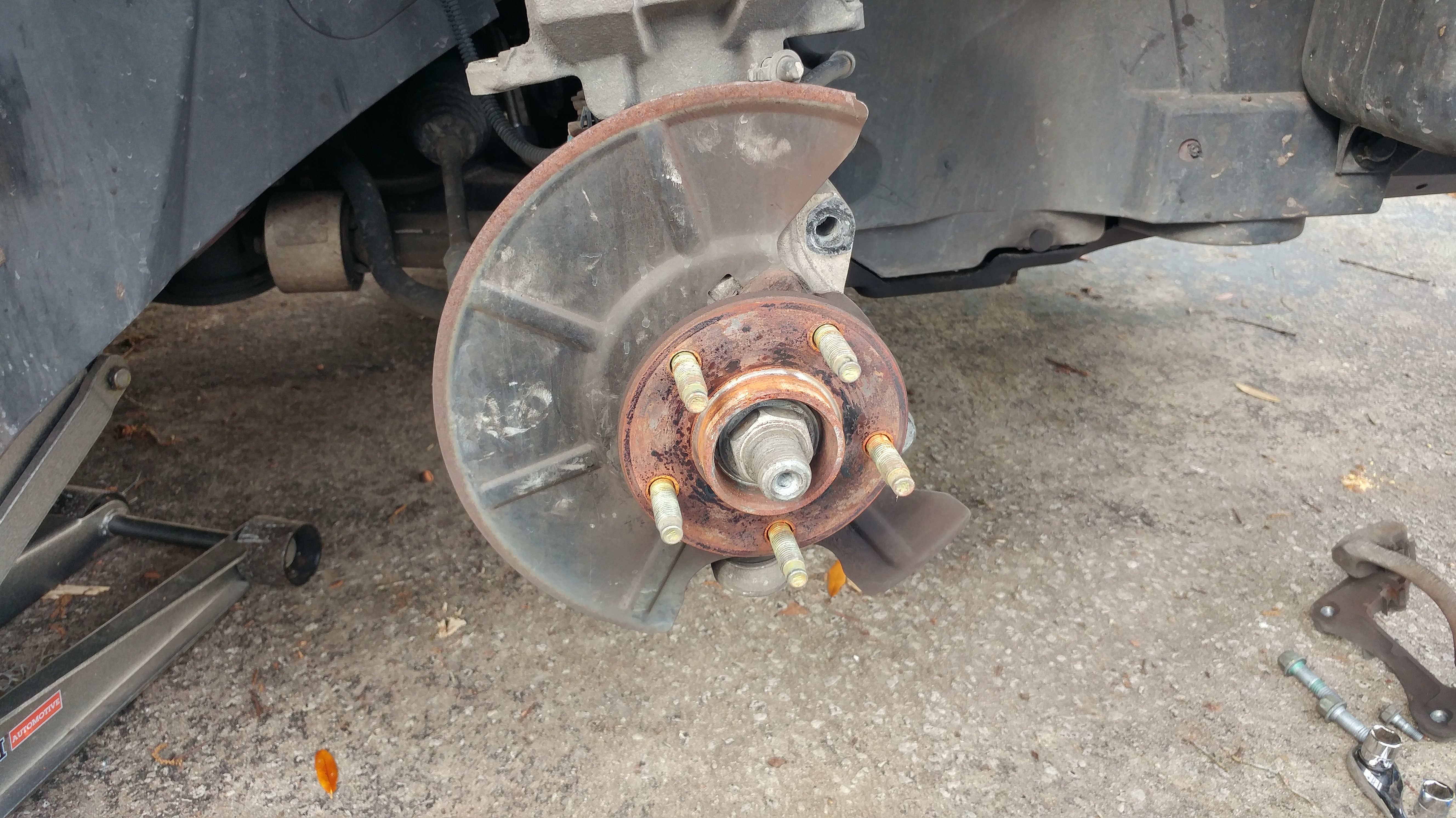

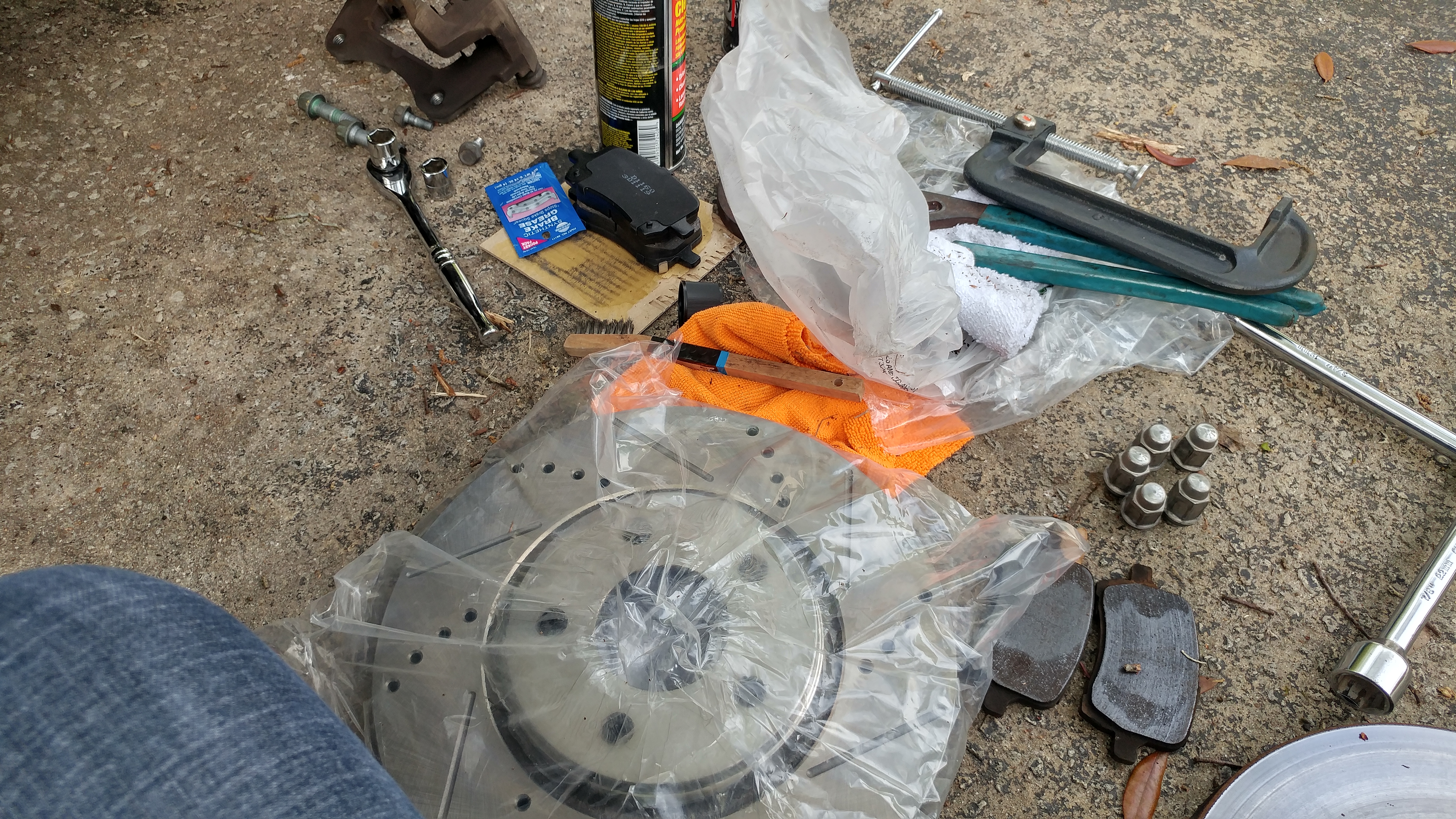

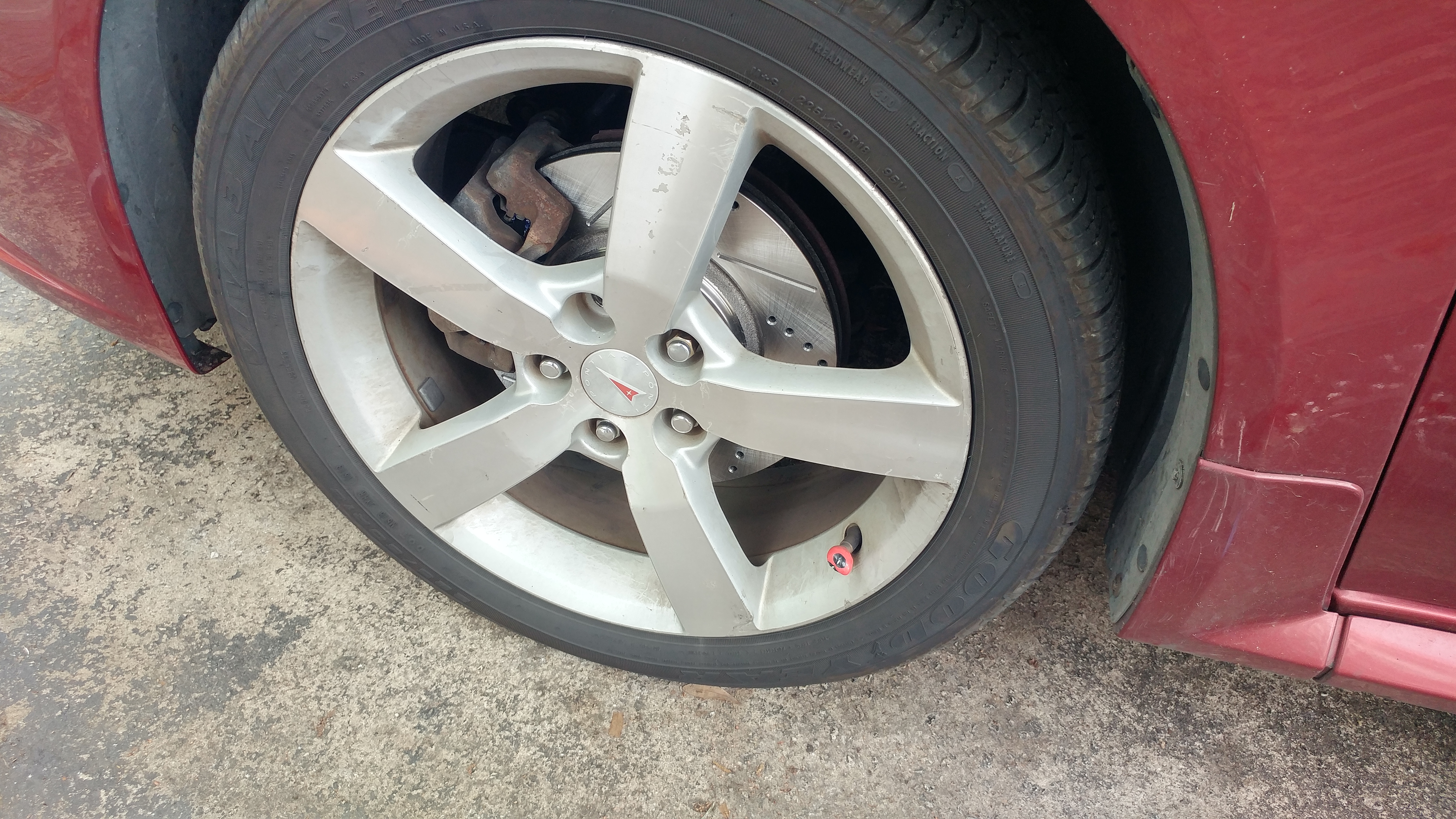

I did my brakes. Cleaned the slides with a wire brush and brake clean then lubricated all the sliding bits. Cleaned off the rotors with the brake parts cleaner, each rotor, both sides twice. Checked all my suspension parts and everything looks great for the mileage. Took the car out and broke in the brakes per manufacturer recommendations then tested braking from 80mph to 50mph to simulate taking an off ramp and no more shaking of the steering wheel. This means my suspicions of a warped rotor were correct.
For some people the slotted rotors are the way to go. One of my family members warps rotors on her car in 10k or less. The slotted ones off the net are at 17k with no problems.
