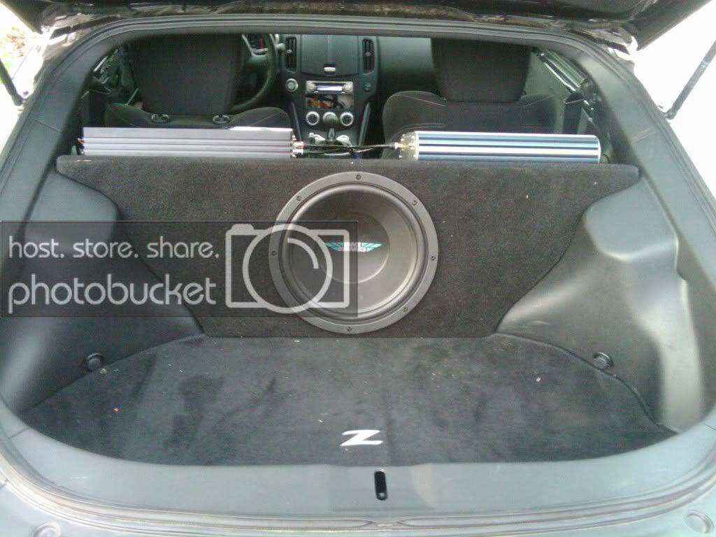

Here is what I am working with. I swapped out he IDQ for the Sa-12.

Why the downgrade?
The IDQ is a very efficient light coned woofer...pretty much the opposite of what you're trying to power now. It's why most people recommend huge vented boxed and gobs of power for them. If I were in your situation and was looking for an uber woofer to use in that enclosure, I would have pulled the trigger on an IDMAX and mount it inverted so the magnet sticks out.

I was liked how musical the IDQ was but I wanted a little more impact on the low notes. I kept hearing about how the Sundowns are able to be used SQ but hit a little harder. I wanted to try it. I think my mids would drown out the ID now. I have thought about switching back. I really don't want to have change out my amp. Since it is screwed down to the box, I don't to punch a bunch of holes in it. I have the amp set so there the crossovers are open and am using the HU xover at 63hz. It's Pioneer 3300bt. I don't know what the slope is.
