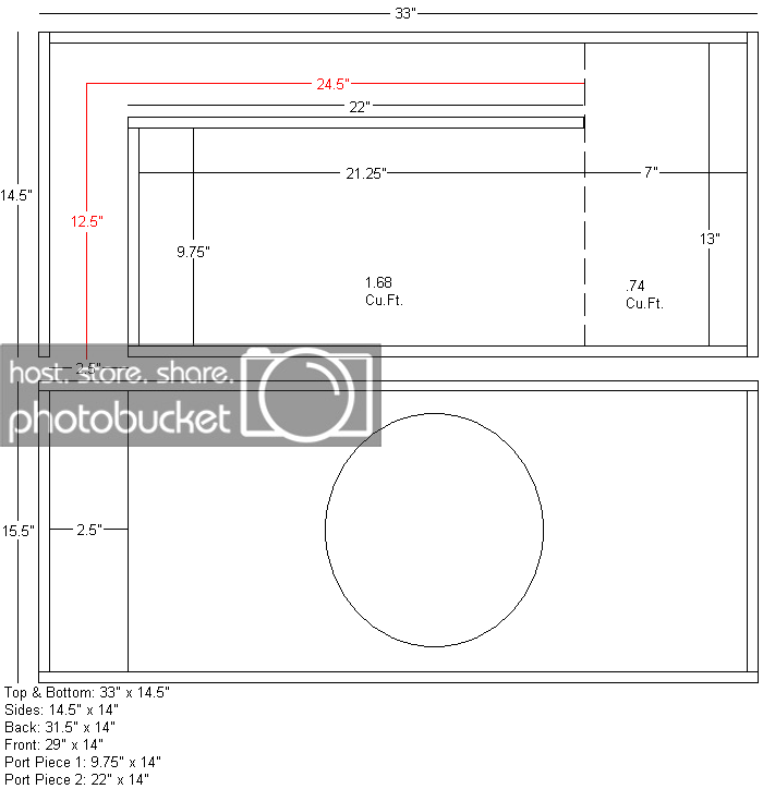

E eric12421 10+ year member Senior VIP Member 244 0 RI Apr 20, 2006 #1 hey....i just built this box were would you put the terminal cup....i didnt know if putting it in back like in hte port would create port noise or anything...thanks Click to read more...
Ingleside 10+ year member Senior VIP Member 383 2 San Francisco Apr 20, 2006 #2 put it on the right hand side. if your wires come from the left hand side flip the box and put them on the left.
OP E eric12421 10+ year member Senior VIP Member 244 0 RI Apr 20, 2006 Thread Starter #3 alright thank you very much thats kinda what i was thinking but i figured id ask someone who really knows....
