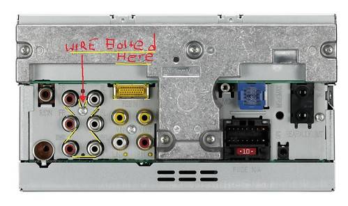

Thank Architect, Is this what you mean by reground?

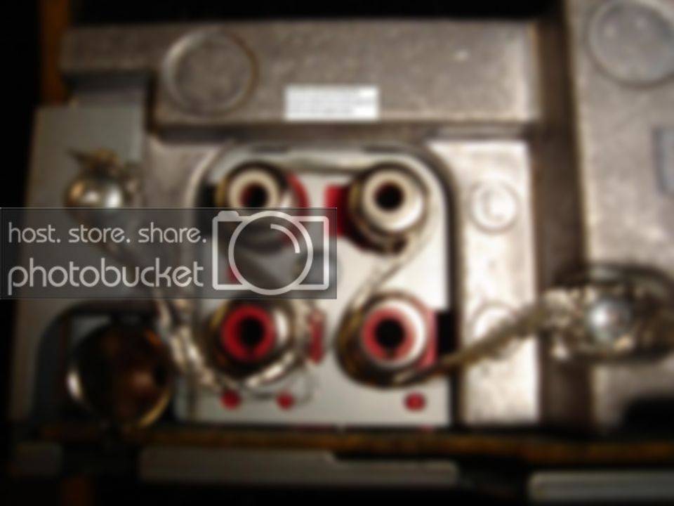

I'd go about grounding the audio RCA's first. To see if that takes away from the hissing. I'm awful with Paint, I'm so much better with a pencil and paper. Just make sure you use decent wire. Some good speaker wire should be good enough.
1:Strip away the rubber/plastic sleeving exposing the wire completely. Twist the wire all around to get all nice, neat and tightly wound.
2:Then unscrew that screw in the middle of RR, RF RCA jacks some. and place the wire there and gently screw the screw back in place while pinching wire between screw and radio.
3: Then begin to loop the wire around RCAs.
4: When your done looping the wire nice and tight around all the Red/White RCAs return the end to the screw back to the screw and twist both ends together. Cleanly cut off any excess wire. Want to keep things as neat as possible. Don't want to short anything out by have 4 inches of exposed wire hanging behind your HU lol
5: Might need a small washer of some kind for the this but now try to pinch the wire down when you tighten the screw back to keep it all in place.
I hope that helps you get some idea of how I grounded my Pioneer HU. =)
