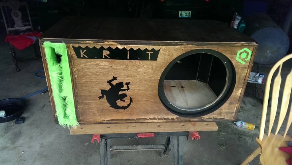

Btw, Box went in today as well! More than happy with the output compared to the last box I made! You are the man! Thank You for all of your help
