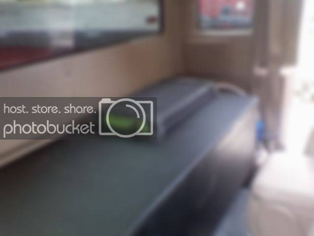

here is mine as of right now.... Im debating on throwing in an 18 or two 15's. For the 18 might go with RLP and for the 15's re se's due to my power restrictions but here is my box. Nothing special here gets the job done. Subs Down Port Down. Its roughly 3.2ft^3 @ 30hz. Sounds great!
if you spot a cap your not mistaken!! I had really terrible alternator whine and that actually took care of it!
