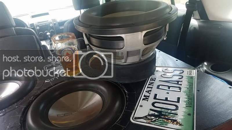

Spider looks right. I'll take your word on the coil ID and OD. Looks about the right wind width though. Are those the new Sundown cones? Man I paid I think 50 a pop for some from Jacob when they first came out. I've got one left here... would be a shame if they're worth so little these days
In general I've found cones make little to no difference in the final product apart from obvious mechanical limitations and of course cosmetics.

I agree with your comment for the most part, it won't make much difference in the end for high power guys. As long as it has the throw. It sure looks like the new Sundown cone, not sure if it's the genuine article. I would imagine it has to be close for stiffness and it certainly has more mechanical run-out. The spider and coil are not the genuine article but they are very nice quality copies with the same dimensions. The spider has a bit more resin than TC spiders but they loosen up nicely and get much quieter over time. I've had plenty of them in my hands, they'll get you the stock sound and performance. But you're right, the leads can be a limitation for some folks who are really throwing down power. He offers lots of 10x3 spiders with beefier types of leads, and an 8 layer coil with the same dimensions, so you could really step up the power and reliability of that driver in a rebuild.

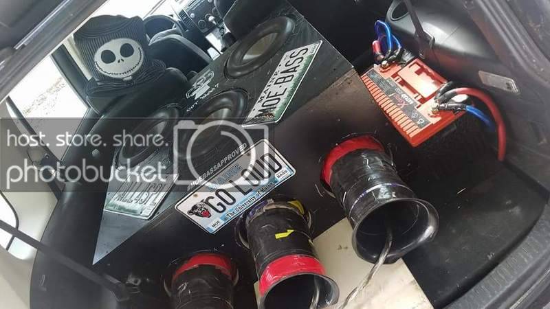

Got them all fired up. Now that that is out of the way, I'm leaning heavily towards selling or trading them. They sound unreal and do everything I thought they would, but I'd like to see what kind of other options are out there I think!
