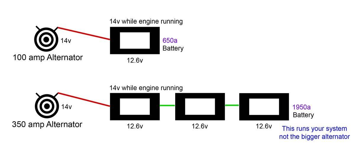

But for the final time. You don't need a bigger alternator and voltage drop is 100% normal and going to happen. I can get into the mid 11 volts if I try and I have 5 batteries and an HO alternator.

Oh, and the bigger alternator is not going to hurt anything because the voltage regulator only lets a certain amount of voltage output. You could have a 500amp alternator but if the voltage regulator is set to 14v... then 14v is what you get. You will still get voltage drop. It will not fix a problem like a loose ground.
