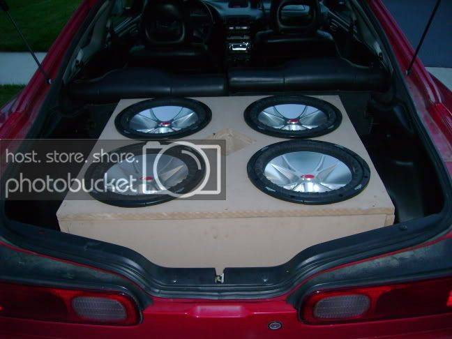

Haha. Dude, REALLY? I'm building a 3.5 CuFt box in an Integra in about a week.
It's all planned out. You have PLENTY of room.
(unless you have the sedan, then you're just a *** //content.invisioncic.com/y282845/emoticons/fyi.gif.9f1f679348da7204ce960cfc74bca8e0.gif)
P.S. Second Gen Integra 3-Door.
