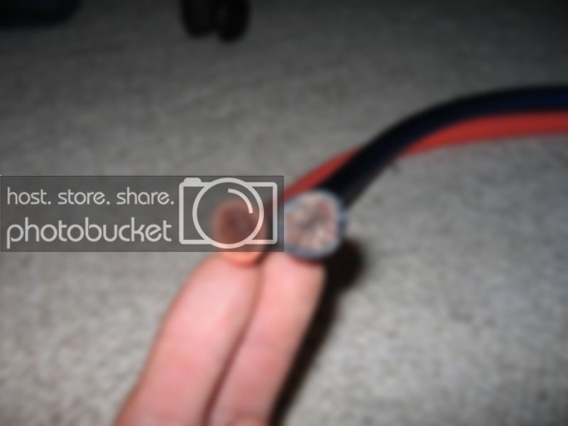

After some practice, I found the right combination of settings and light. Here are some good pictures... (Excuse the dog hair)
Both wires pictured are sold as 1/0.
Left is Welding Supply Ultra-Flex. This is true 1/0. Right is Kicker Hyperflex. Kicker is 2/0 in size. As you can see Hyperflex is huge.
so the welding is more of a standard 1/0 where the knu and kicker is oversized?interesting..
Yes, normally welding wire goes by the AWG rating where as car audio wire does not. You will find that there is car audio 1/0ga wire that is actually 4ga wire and 1/0ga car audio wire that is actually closer to 2/0ga wire by the AWG standard.
