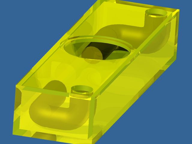

okay, i know that i need to get the correct length but will this work???
OK, that would work, but, I gotta ask?
If the intent of the design is replace the rear deck with an enclosure, a ported enclosure at that, why not just do that and bag the ABC enclosure design altogether.
Seems to me your making the whole design process more complicated than it needs to be for what you want to achieve for what a regular ported enclosure design will do for ya.
you are correct! I did decide to bag the ABC design. The reason i wanted the ABC was 1) for stealth and 2) stealth enough so the kids wouldn't punch out my cone.
After chatting with Thumper he suggested just place a grill over the cone to protect it. Also to get the desire frequency the box was going to be too big for what I needed.
Porting in the rear deck okay...
You get decent output, and it extends LFE... but you lose a lot of the response/output in the trunk itself.
If you build that box, you'll notice that it sounds pretty good... but you gain a considerable amount of output when you open the trunk lid of your vehicle...
nG
Just design a simple ported box. Work out the internal volume, port displacement, port area nad port length, external dimensions, etc. on paper or calculator before you do a CAD drawing of it. Once you actually get a DESIGN down then you can draw it out to help you build it.
i use the cad drawing to visualize what i want using rough numbers. The program i use takes less than 5 minutes to create a box and less than 30 seconds to change dimensions. It will also give volume. So that is why i put it on cad.

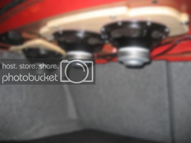

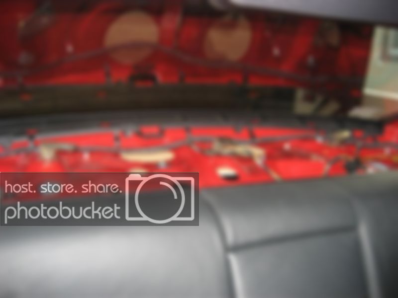

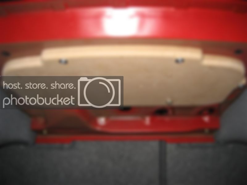

dude no. just make a board that attaches to the rear deck - as big as possible. then take it out and cut your speaker holes. mount speakers from the bottom. and then cut small holes in the rear deck to open the cones to the interior of the jetta. this is in a BMW M3. similar idea.
easy as that. just seal up around the edges of the wood with some silicone between it and the metal, cut 4 8" holes square if you want em to be, does not really matter.
and you will be done. easy as that. stop making this harder than it should be.
