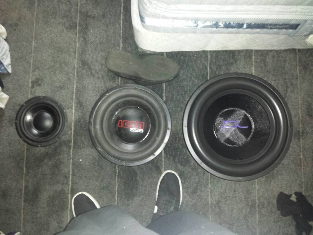

Oh hohoho

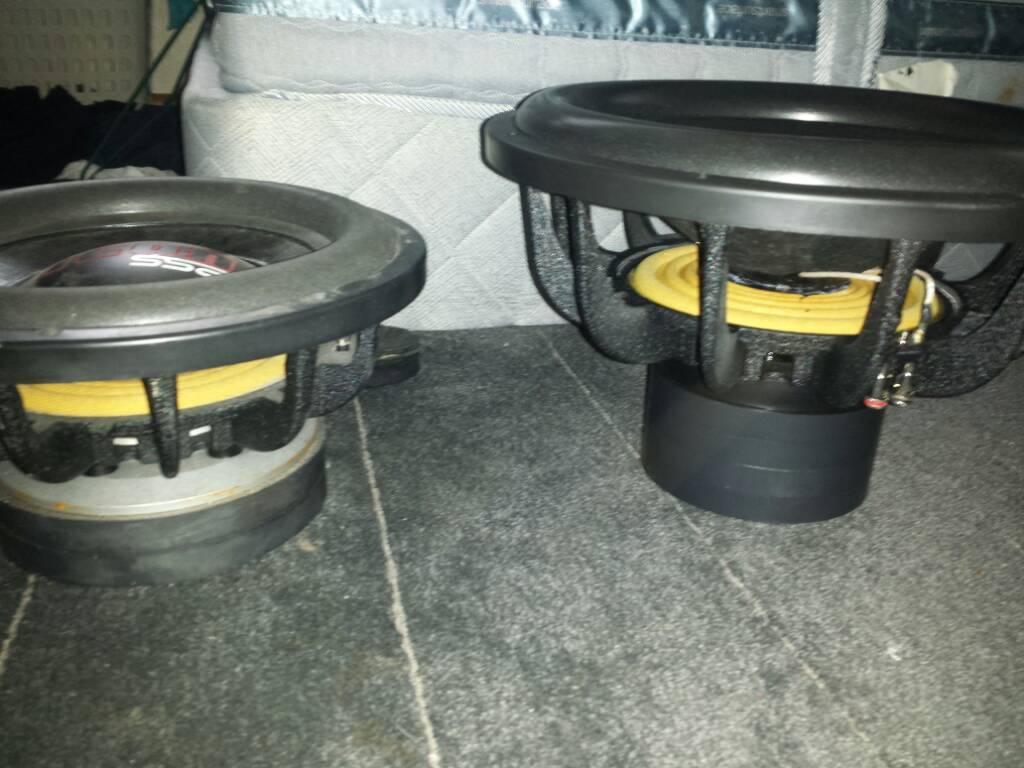

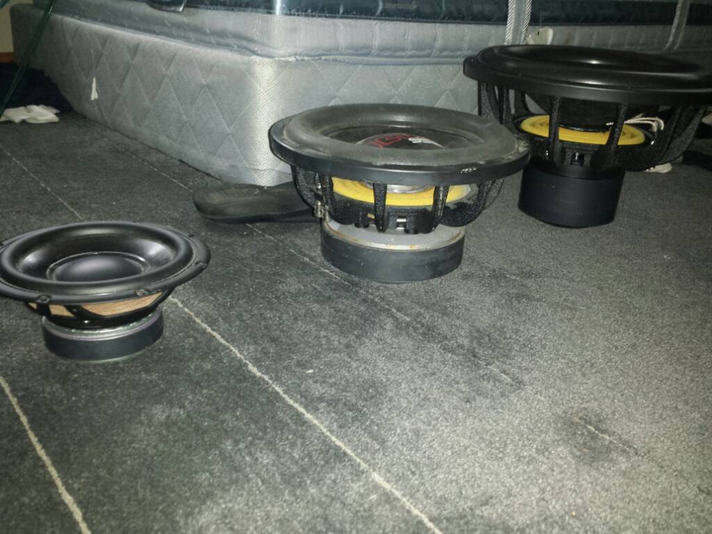

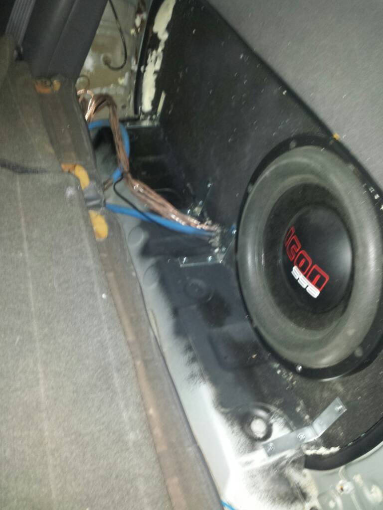

Fi ib3 15s. New
Old. 12"ssa icon

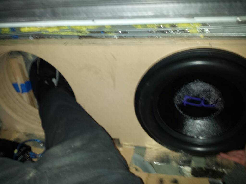

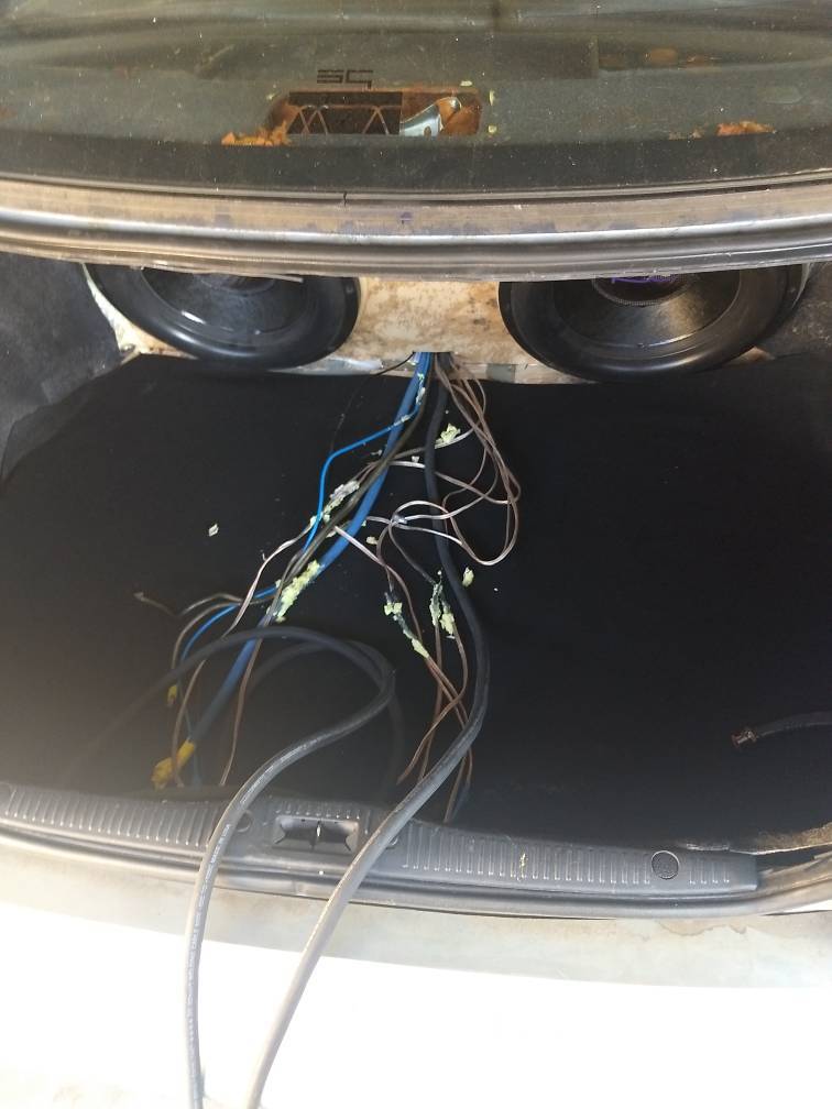

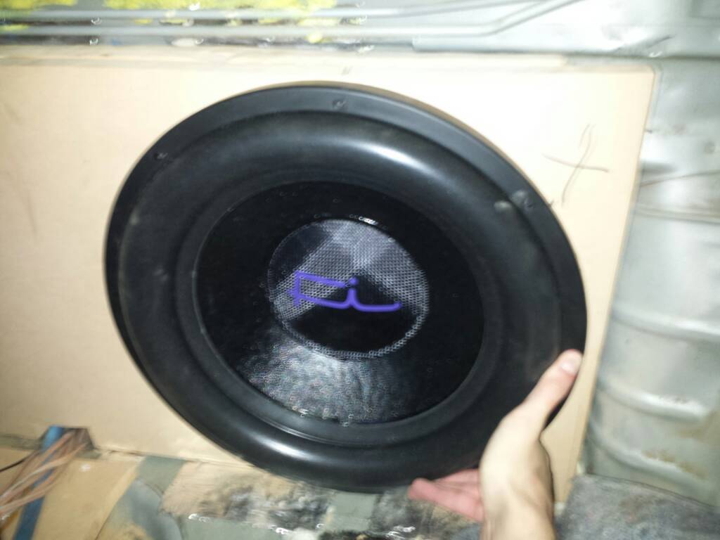

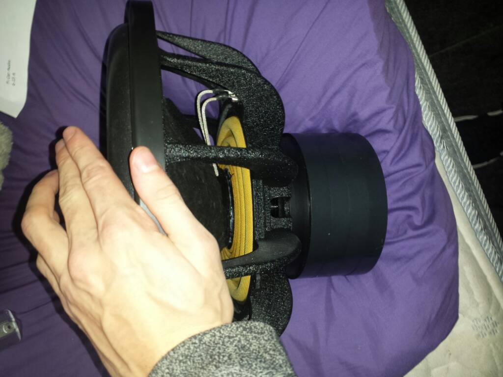

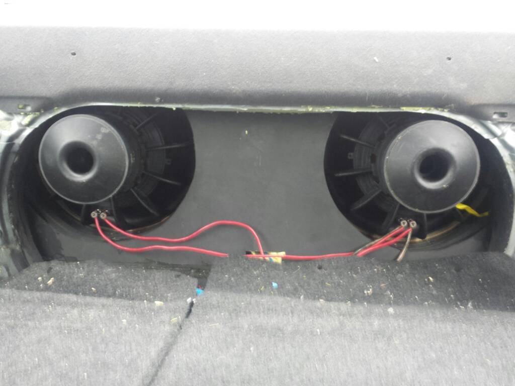

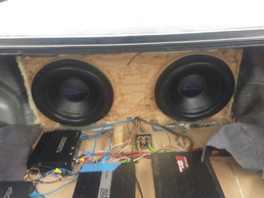

IB sounds so good and that looks like a nice driver, you like it so far?
How come you faced the motor side (and associated turbulence noises) into the cabin? It's probably pretty quiet most of the time but I would think you'd still have mach noises in the pole vent with high excursion.
My trunk design wouldnt allow me to face the drivers forward. There was only about a 13in hole into the trunk so instead of cutting metal on the front and lookiglng janky. I just built a thick a baffle and reversed them.
Ive tracked every rattle in the car down so the only noise is slight mechanical noise but at high volume its really not noticeable unless you're listening for it.
