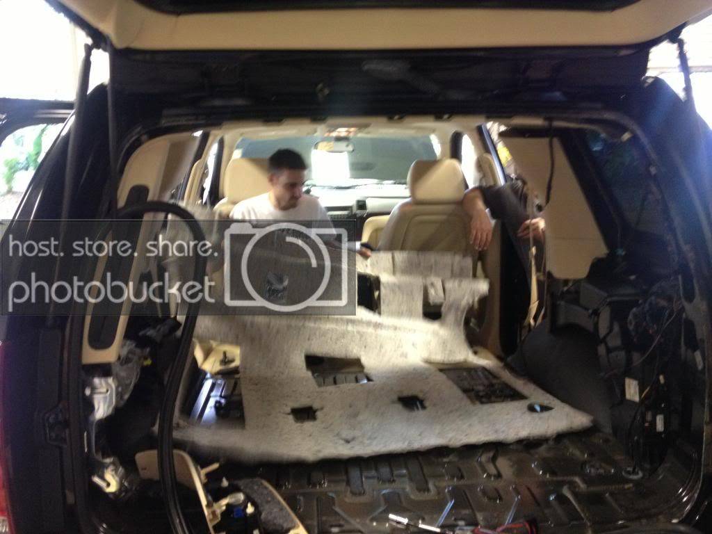

The time has finally come to build up a company show vehicle - so here is the build log where we will keep you all updated with a ton of pics, vids, and other cool stuff as it gets done!
I hope you all enjoy it! It will be at SBN 2013' making a debut if you want a live demo!

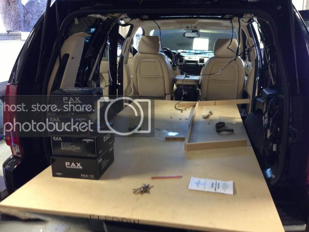

Middle Stage (Front of Sub Enclosure / Trim Panel)
This will all be built into the trim panel behind the front driver and passenger seats where the front of the subwoofer enclosure will end. We will be using 3/4" Birch for the build, obvious bracing, etc.
