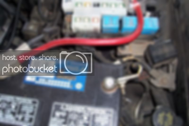

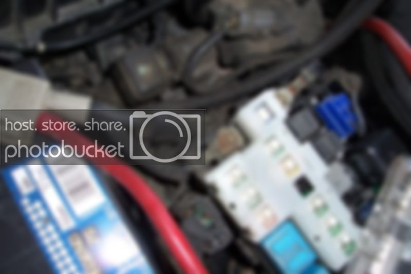

Here is my delima, the alt is hidden badly, but before the wire gets to the balt it goes into the fuse block. Do i bypass it, or what?
