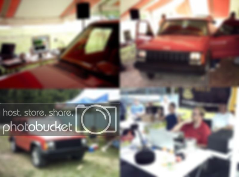

4. I loved my DMX prototype. The sub could take a beating and keep on putting up good numbers on the termlab. I love that you can just recone the sub by taking it apart and not using a single drop of glue. I think you can see a bunch of pictures of the dmx in action if you check out my Myspace link in my signature. All in all, Massive audio equipment is great stuff, but the company is piss poor on promoting and sales - but that has really nothing to do with the product which is great. More people should be using Massive, but most are too chickenshit to try a semi-new brand.
But here are a few random pics of me using my DMX
