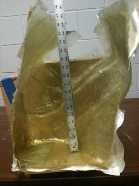

Here are 2 pictures to show the the initial shell. I know it looks like hell now, but after additional layers and trimming it it will be a lot prettier.

Here it is with the flush mount MDF ring in place. I had to test fit the sub and test it in the car a few times to get the ring in a spot where it wouldn't interfere with the cargo bin. After it is in place I used a thick glob of resin mixed with fibers to lock it in place.
Here it is with the initial wrap of fiberglass on the front
I trimmed it up and test fit the sub.
