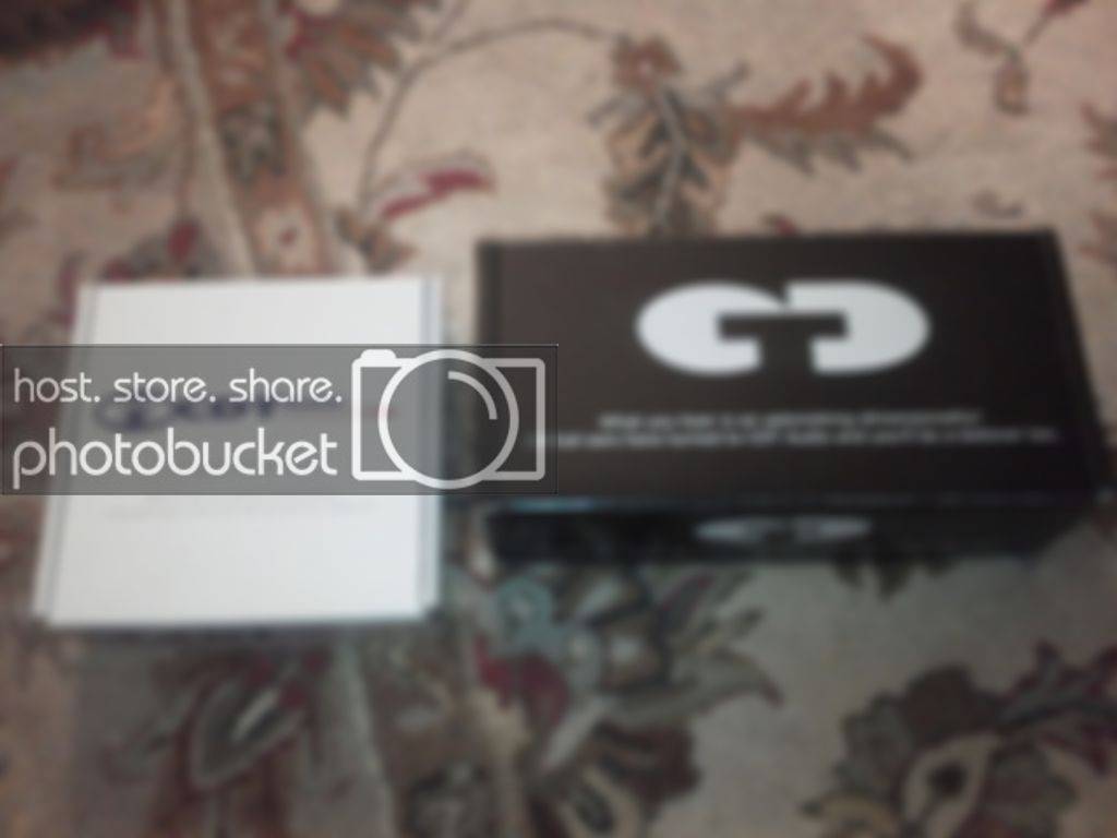

New CDT Toys :):):):):)
BassAddictJ

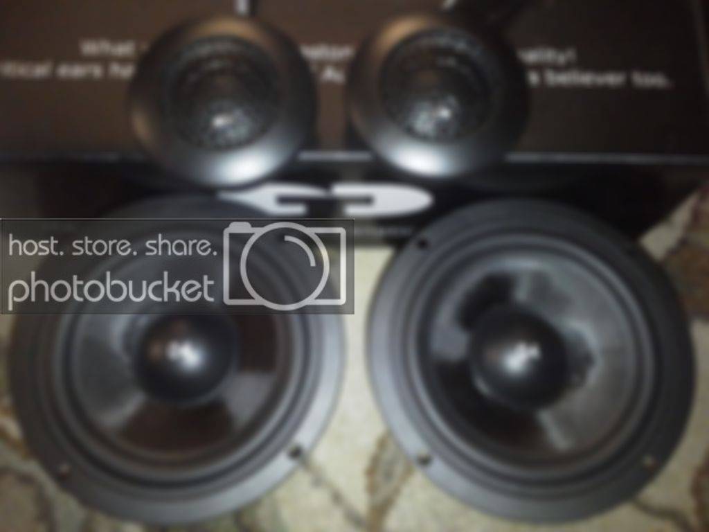

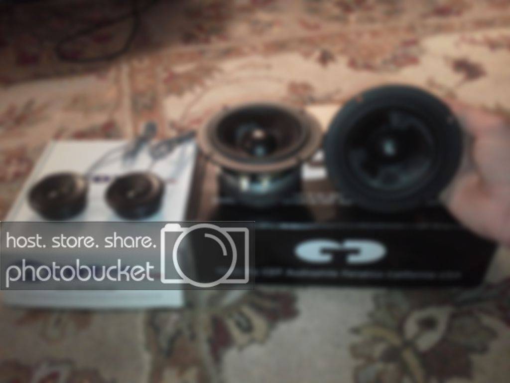

CDT DRT-25 silkdome tweets
CDT ES-04 Midranges
which are coupled in a 3 way front stage with some re xxx 6.5 midbasses in pods off my **** *** ppi art ax606.2

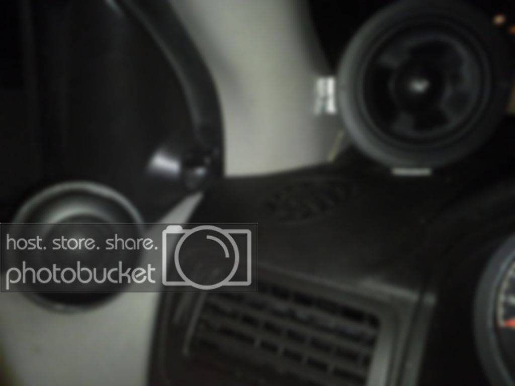

Got them installed roughly tonight. The 4's fit the same mounts as my previous DLS IR3's much tomy surprise. In essentially free air the midranges sound pretty **** good without fine tuning or being in sealed pods. Over the next week or two I plan on getting some pods glassed for these midranges....
and the tweets are smooooooth:)
HOLY CRAP I am impressed.
Got the midranges in and retuned. I must say for being free air these still have amazing output and still do the upper midbass with authority. In fact they sound jut as crisp and clear as the DLS IR3's but definitly get lower. Tweets are 5khz and up, midrange 310hz to 4khz, and midbadd at 255hz down to 50hz. Before I had my midbass up to 350hz ish and it sounded okay, but now that they are about 250 and down the midbasses have cleaned up quite a bit. I can't wait to hear how the es-04's do with a small enclosure. Minimal work needed to get these tweets to fit into my spaker pods that once housed my DLS IR1's.
These speakers were all B stock from CDT store, new with 1 yr warranty for like half of off normal online price. I gotthetweets andmidranges for 220 shipped. Holy jesus I am so happy I got these.
got to drive like 25miles tonight on my misc adventures, got to play with the levels more. Those xxx's should never have been higher than 250hz before. they're great now. I was worried about the upper midbass switchoff between them and the es-04's with the 04's on the dash. Not an issue at all. It blends nicely.
I honestly couldn't find any blemishes anywhere on these. I have no idea why these were considered b stock, they look new and amazing. //content.invisioncic.com/y282845/emoticons/smile.gif.1ebc41e1811405b213edfc4622c41e27.gif

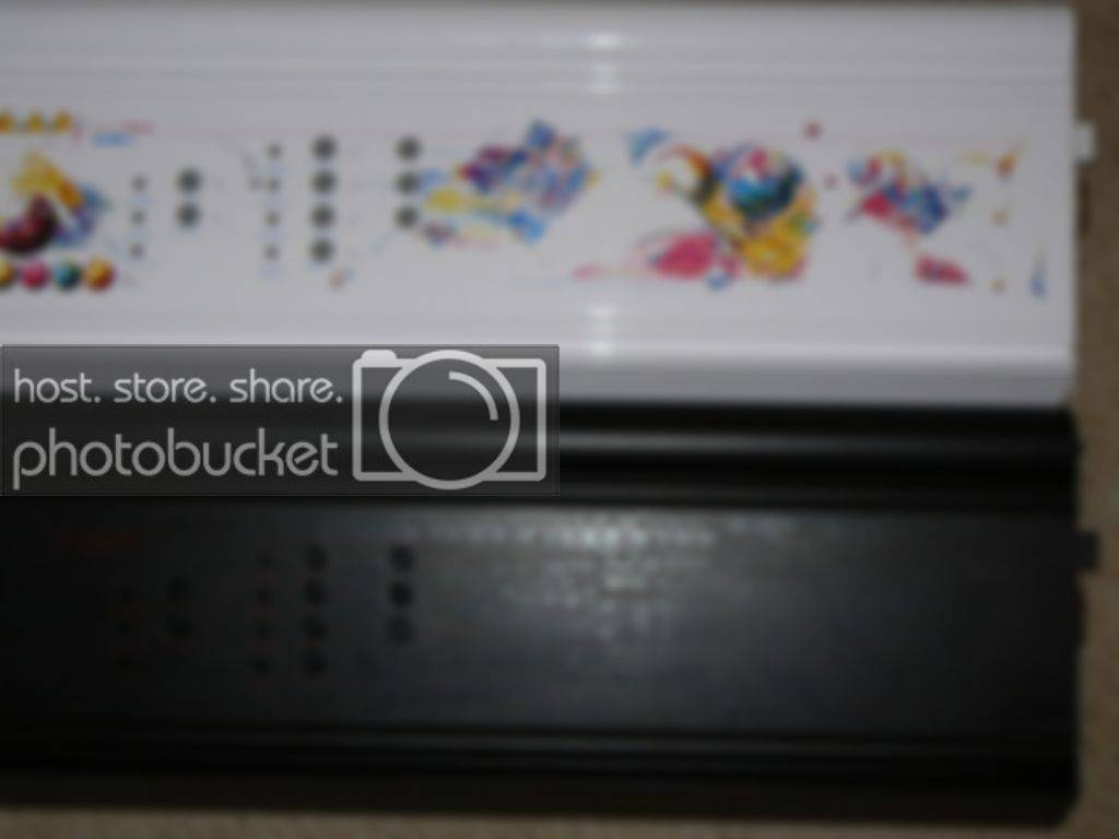

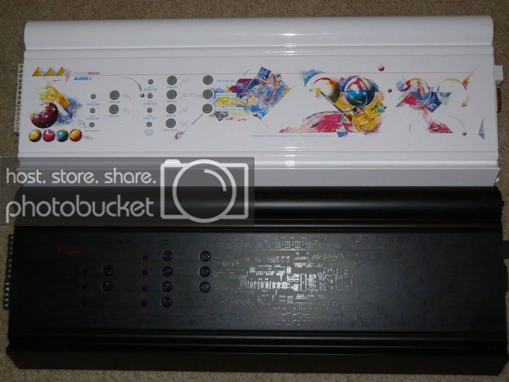

The clean power from the ppi really shines too. //content.invisioncic.com/y282845/emoticons/smile.gif.1ebc41e1811405b213edfc4622c41e27.gif
god i love this amp....guy who I bought it from calls me recently (about 2yrs of having it) and asks if i ever installed...wantedtomaybe buy it back.
negatory sir, sorry...
wish i kept that white one too //content.invisioncic.com/y282845/emoticons/frown.gif.a3531fa0534503350665a1e957861287.gif.it got sold
BassAddictJ, interesting placement on the ES-04s. What kind of mounting bracket did you use?

The mounts are fairly simple. mdf ring cut outs painted black, connected to the adjacent panel by L brackets and bolts. I added a little bit of double sided heavy duty sticky tape for extra support off the glass and dash. Not the prettiest, and I had to drill into my panel, but it gets the job done. I don't have the same kind of time I used to to make it pretty. Whatever next car I get down the line I'll do it right and have glassed pods for everything.

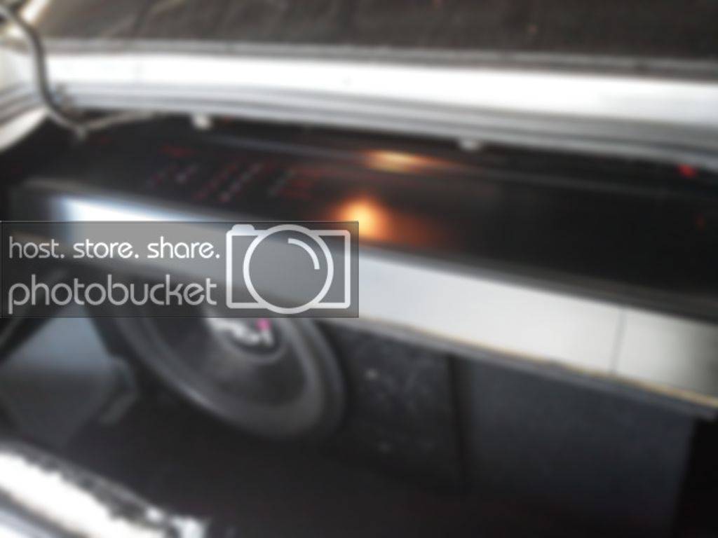

The sub is:
Silvertop tc4hp TRF Motor
Candy Blue Ti Basket 15"
4 10" Progressive Roll Spiders
Dual Sewn In Leads
4" 8 Layer Flatwound Coil D2
6" Carbon Fiber Dustcap
8 Gauge Direct Connect Leads
cool pics and ish here:
http://www.caraudio.com/forums/general-discussion/558353-vids-trf-psi-monster-us-amps-ax3200de.html
Nice build, amps look sick, wish i could hear it all
it really does sound incredible. took like 10 years to get to this point but finally I'm impressed daily with all aspects of it. Love my indash navi and 16bg thumb drive of music, the ppi eq and amp are like 15+ years old and , the us amps is handmade and ****, the sub is overbuilt and mean, the electrical is pretty stout, mids and highs are now fantastic again.....amazing...
Cool man. Sounds like you got a pretty dam nice setup. That sub is beefy as he'll.
