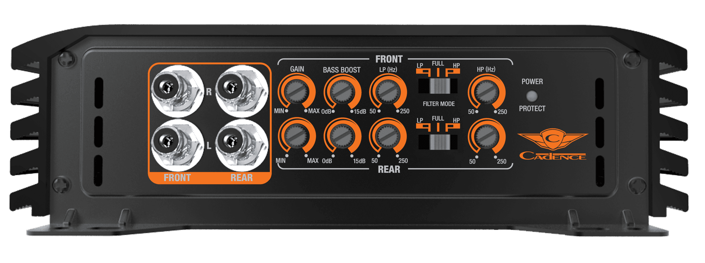

class H bid power!! i wants um. someone by my shitzz. lol

cadence QRS have always be one of my favorite amps. these are special because of hte power supply. it has multiple "rails" with another switching supply. one rail has another stepup transformer to increase voltage over another set of output transistors that are ONLY turned on when needed. its a viable option to class D power supplies but has a true analog output not a digital output.
typically a good class AB has a 65% efficiency at 4ohm full power. Class D is closer to 85% where as in class H is pretty close to D in the high 70%. the reason is because as the power supply starts to reach its limits it turns on a higher voltage power supply that instantly aids it in efficiency.
in a class D amp the transistors tun off and on. they stay off and on for a specific amount of time or off for a specific amount of time. same with the power supply. these amps don't and in reality sound more natural with nearly the same efficiency.
