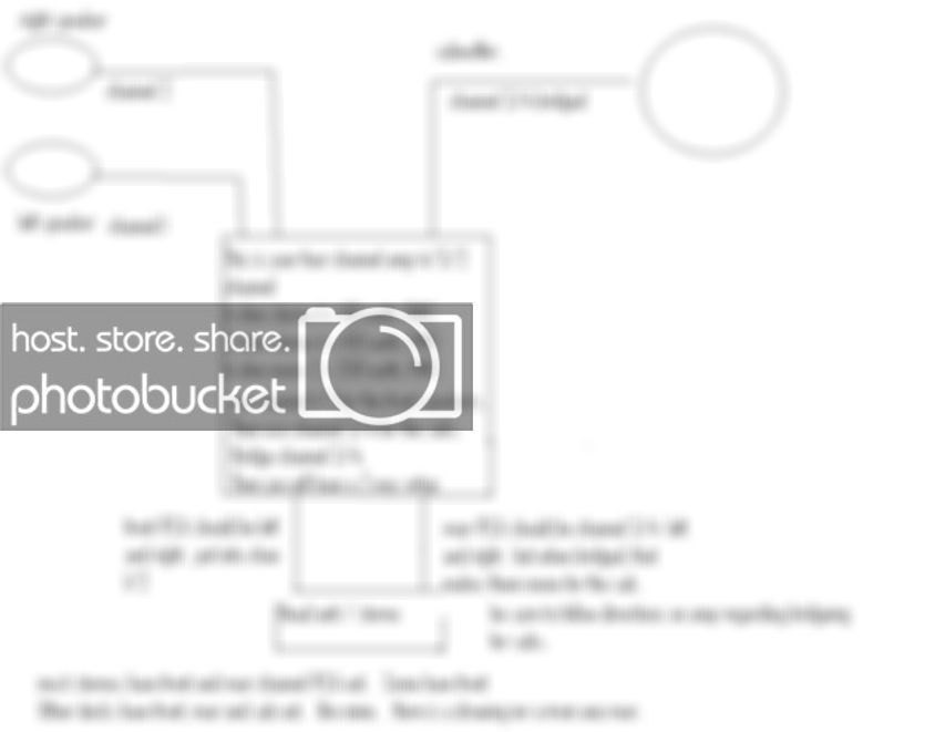

post pics of your install. do you have two sets of RCA plugs. you can use new amp for both. but we need exact model # and brand and pics of everythig and the gauge of wire and elcetrical your running in your car.
i have one running from the head unit to the back of the amp ... but with this new amp i now have the ability to plug two in at once (do i need to purchase another)
and if i do need to purchase another do i run it from the head unit to the amp
will my headunit have 4 ports or just 2 and i need to buy an addaptor?
thanks very much for the diagram, will give it a go when am home.

just get two RCA spliters. for now.
thankyou for all the help subzero ... will pop down local audio shop at lunch.
but in an ideal world i would purchase a new headunit with two rca ports on the back?
speakers are working =]
been down, all sorted thanks a bunch =]
just needed another rca lead and 2rca splitters
yep, thats what I said jo... //content.invisioncic.com/y282845/emoticons/smile.gif.1ebc41e1811405b213edfc4622c41e27.gif pm me if you get more elaborite system issues. and upgrading. anytime.
