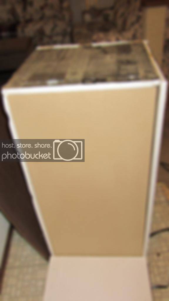

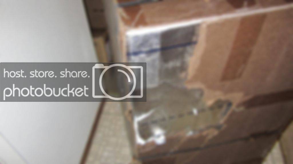

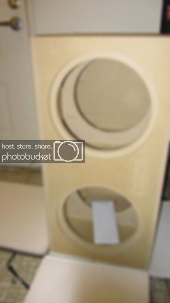

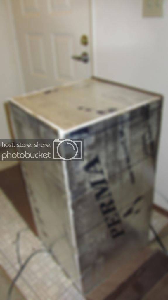

I don't think I have seen anyone post on how good Cherry packs his boxes so here ya go. I got mine today via fed ex. As usual they beat the hell out of it :
[/QUOT
How much was the shipping on that beast ? I live in central calif and been thinking of having something built and his work looks awesome.
I know it **** their rough on packages, it looks like a shark attack!! 1/8th inch fiberboard is meant to protect and spread the load out evenly through the 1 inch sheet foam. My crates cost me about 20.00 to make per package hidden costs no one ever accounts for. Thanks for sharing
