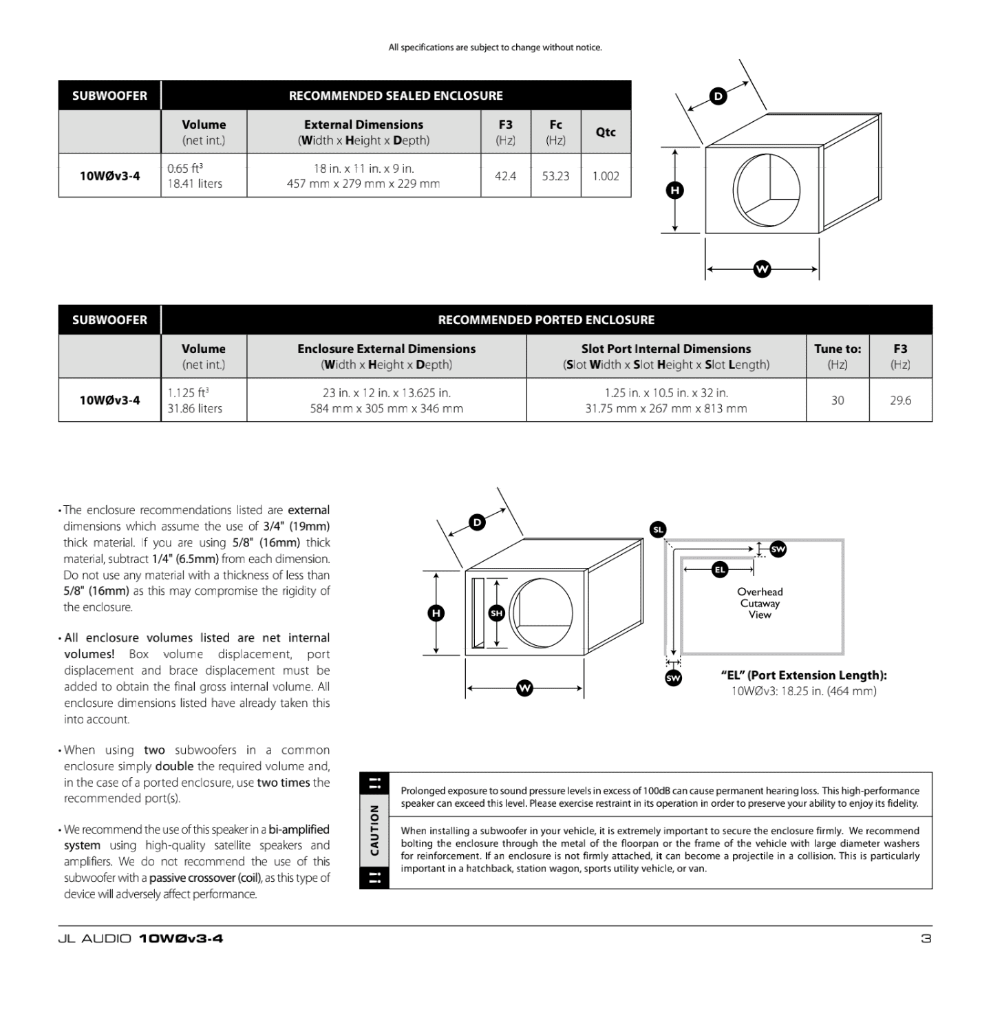

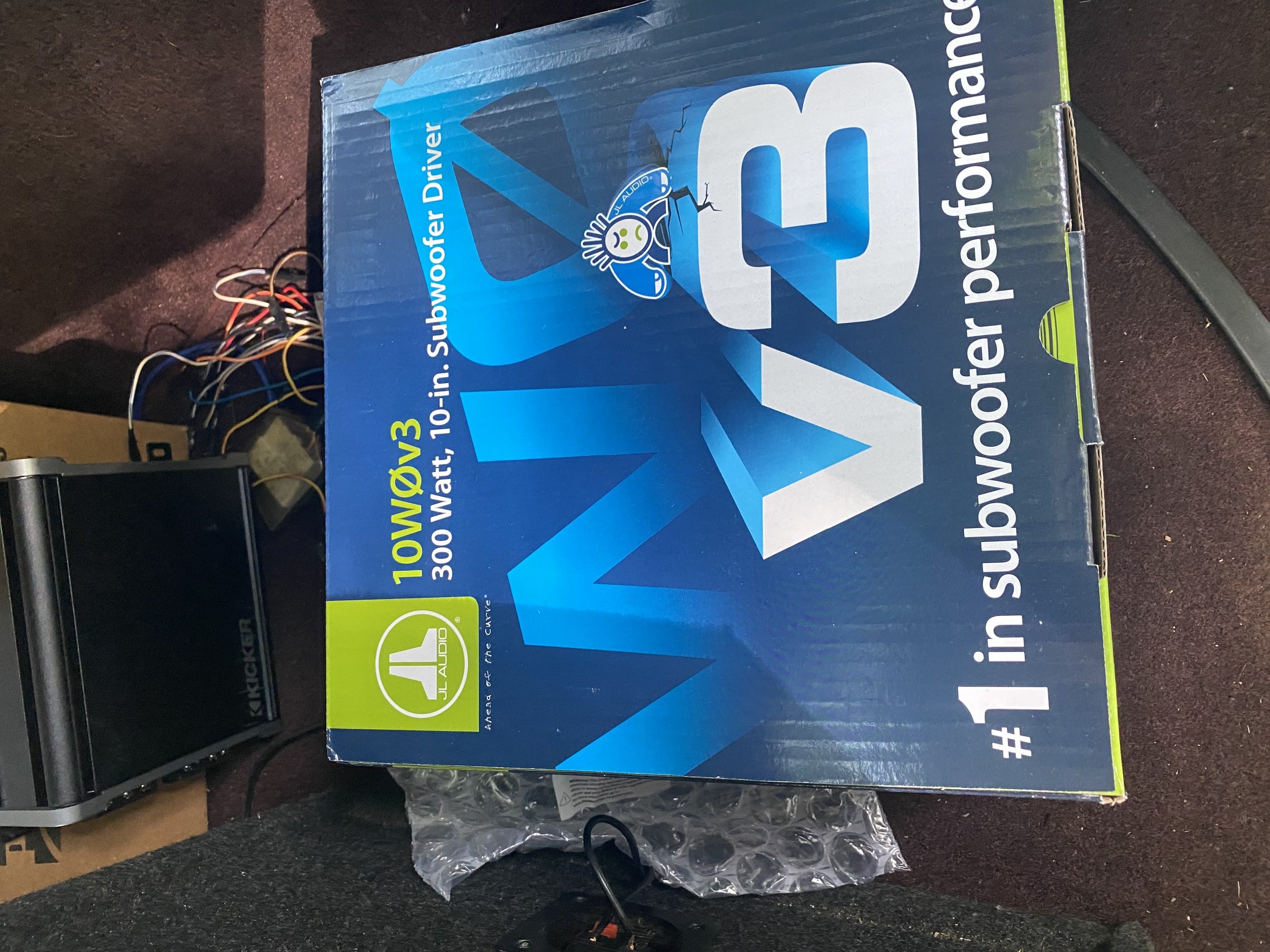

Friend of mine just bought a set of these. He needs an enclosure and I told him I’ll build him one. He listens to mostly 2000’s rap/r&b and maybe a bit of new music that is up to date. I think his amp is like 600 watts or so. He has a Honda wagon. Can anyone help with box plans?
