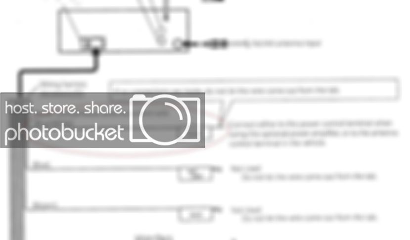

I looked in the manual for my stereo.
Y/N? I'm just covering all bases, making absolutely sure before I go at it again.
