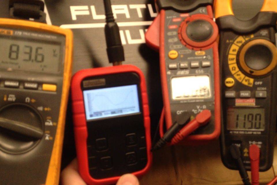

Instead of testing it at different loads and what not, I just went straight to 1 ohm. And since it's a 12v amp, I wanted to see what it would do on less than optimal voltages.
That's 7,000w @ 1 ohm resistive and 11.9v. That's doing work.
