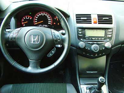

My new Honda Accord comes with an original built in head unit,
my question for those of you who familiar with Honda, is this HU worth anything or if I want high quality listening I should buy something else ?
the problem is that I don't think other Head units will fit there.

I want to keep the original HU but I want better sound.
Do you want to make use of the factory HU as part of your sound system? If so, look into the Rockford Fosgate 3sixty.
If you want to use a different head unit, I would go with the kit that does away with your lower storage compartment. All I ever used my storage compartment for was to store my Ipod that I had interfaced to the factory HU.
you can start by replacing the factory speakers. //content.invisioncic.com/y282845/emoticons/smile.gif.1ebc41e1811405b213edfc4622c41e27.gif then from there if you arent satisfied looking into more processing power(like that 3sixty)
