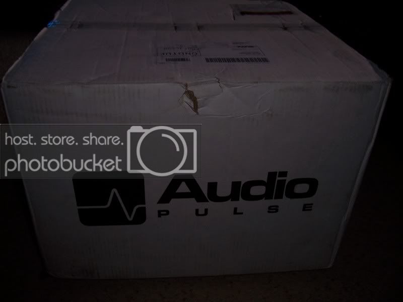

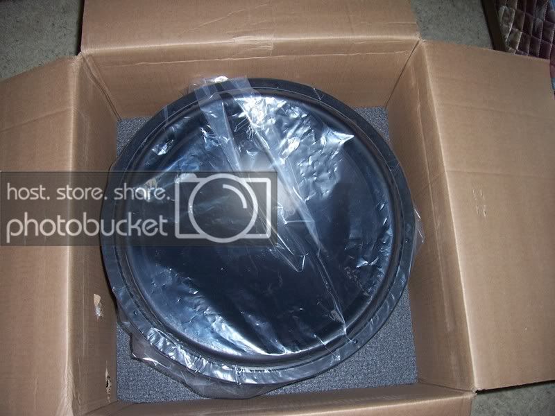

came via DHL
packaging wasn't my favorite, but it came safely with no problems.

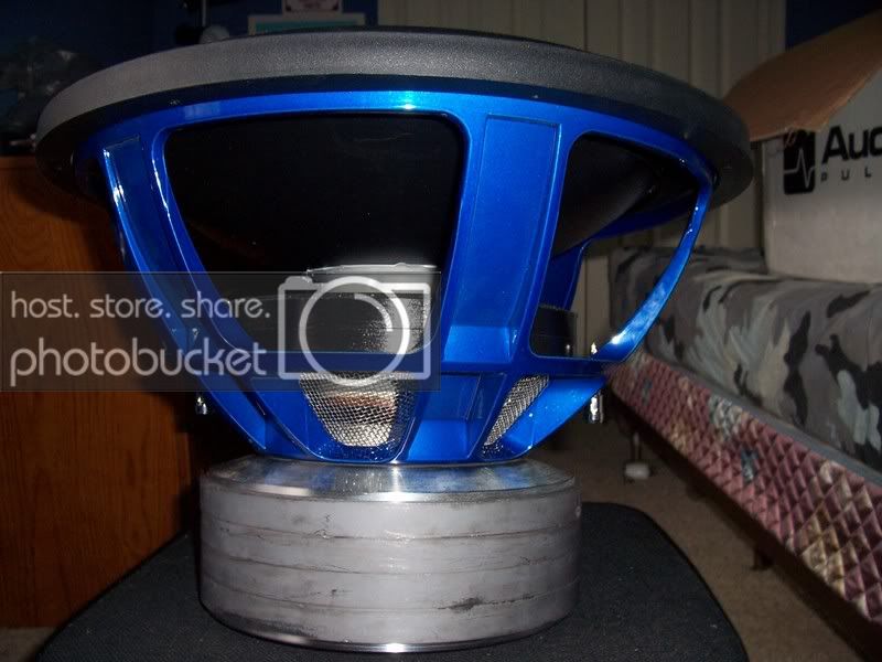

Side Shot-looks pretty stout...

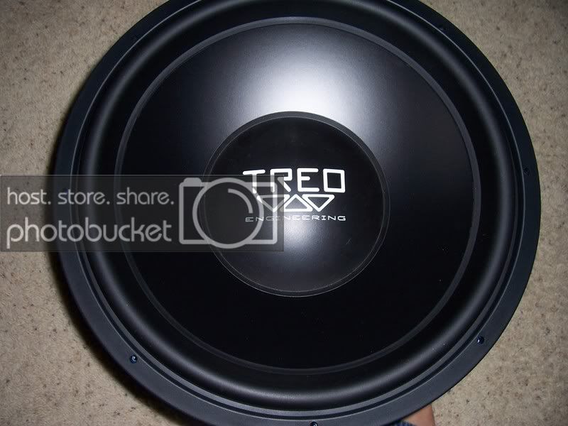

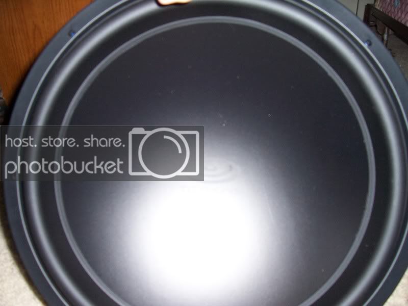

i like the simple anodized cone. I think it's sexy //content.invisioncic.com/y282845/emoticons/biggrin.gif.d71a5d36fcbab170f2364c9f2e3946cb.gif//content.invisioncic.com/y282845/emoticons/wink.gif.608e3ea05f1a9f98611af0861652f8fb.gif
my old ssx dustcap sitting on it...

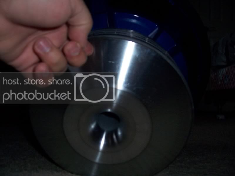

teh azz shots //content.invisioncic.com/y282845/emoticons/biggrin.gif.d71a5d36fcbab170f2364c9f2e3946cb.gif

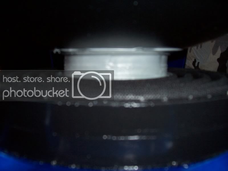

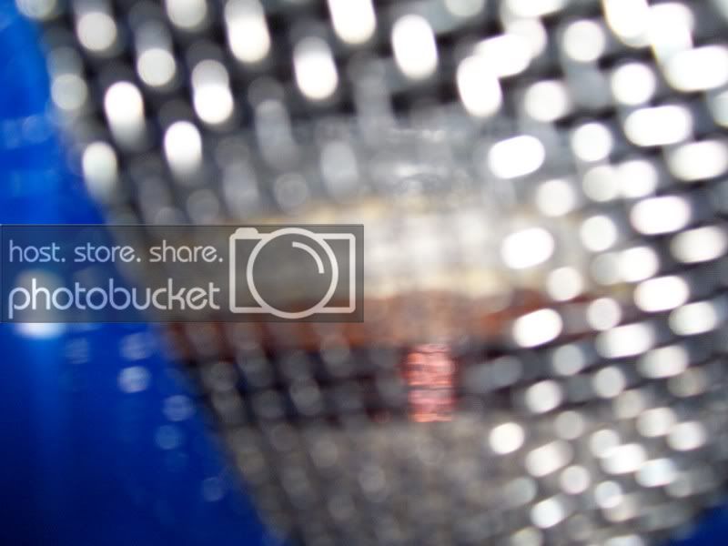

trying to get a decent shot of coils...

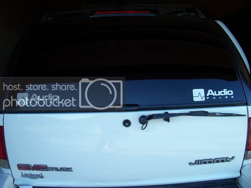

shot of the vinyls provided by egg (spl140.2)
I don't particurlarly like stickers but i figured what the hell. //content.invisioncic.com/y282845/emoticons/smile.gif.1ebc41e1811405b213edfc4622c41e27.gif
Thanks Egg for putting up with me and for being so fast at getting them to me. //content.invisioncic.com/y282845/emoticons/biggrin.gif.d71a5d36fcbab170f2364c9f2e3946cb.gif

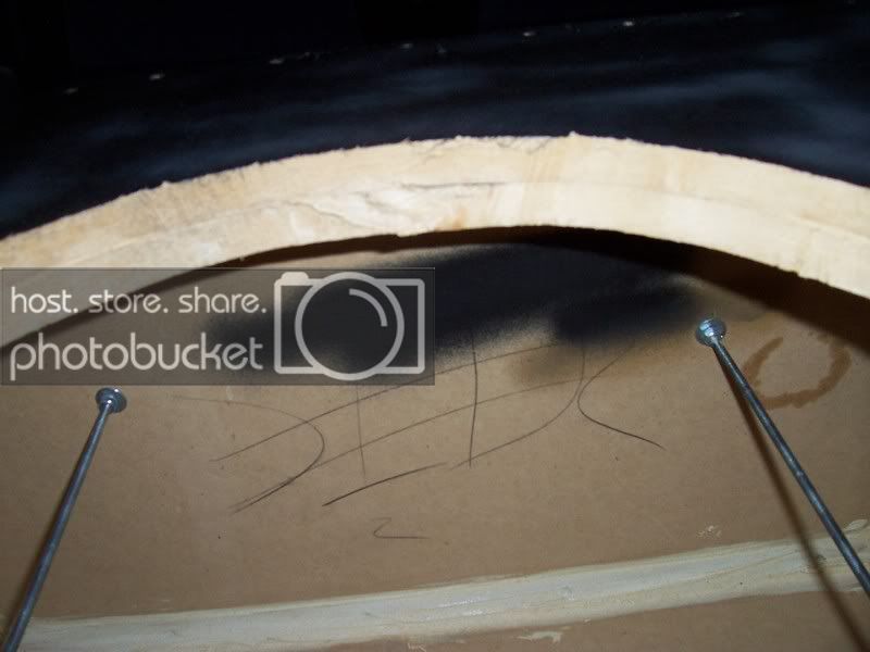

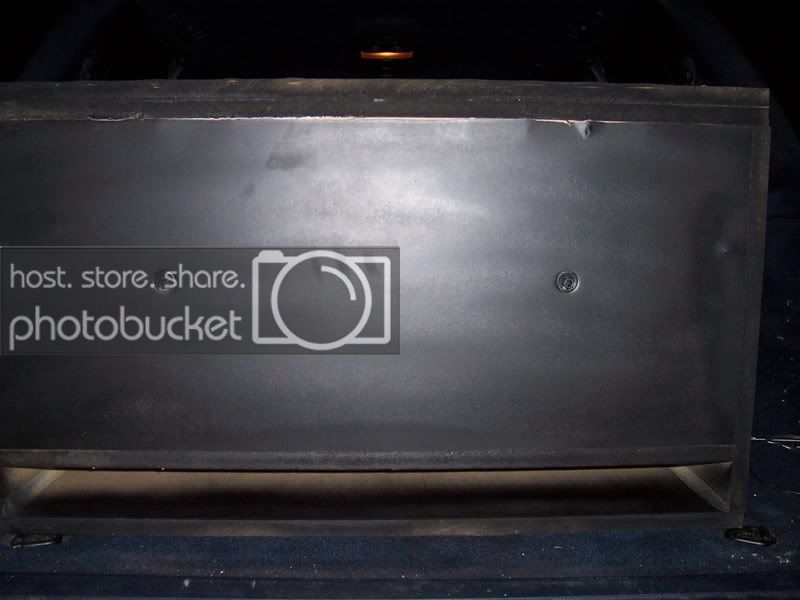

The box for this is 8 cubes tuned to 30 Hz. Double baffled. Slot ported. and braced with 1/4" all thread on x and y planes.
Before you say it... yes i am sure it will take 8 cubes fine. I talked to the man who developed these for over an hour. //content.invisioncic.com/y282845/emoticons/smile.gif.1ebc41e1811405b213edfc4622c41e27.gif
Some pics of the box before it was finished (testing the fit //content.invisioncic.com/y282845/emoticons/wink.gif.608e3ea05f1a9f98611af0861652f8fb.gif )

-It is only a 2 spider setup. However, the spiders are very stiff. Good luck moving the cone very much it with just a few fingers and some decent pressure.
-I need to see what the coils sit at but it is a D2 sub and speaking to the engineer about for so long I was told that they sit at around 1.8 and typically in a 7 cube net box the rise isn't past 1 ohm too much.
-This is a beastly sub... makes my last sub (18" Treo SSX) look small... which isn't an easy thing to do for a nearly 50 lbs speaker.
