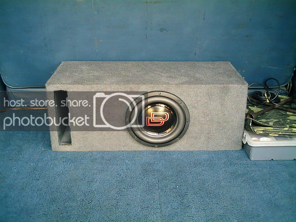

my new 1508
thevic24
my silence is deadly...

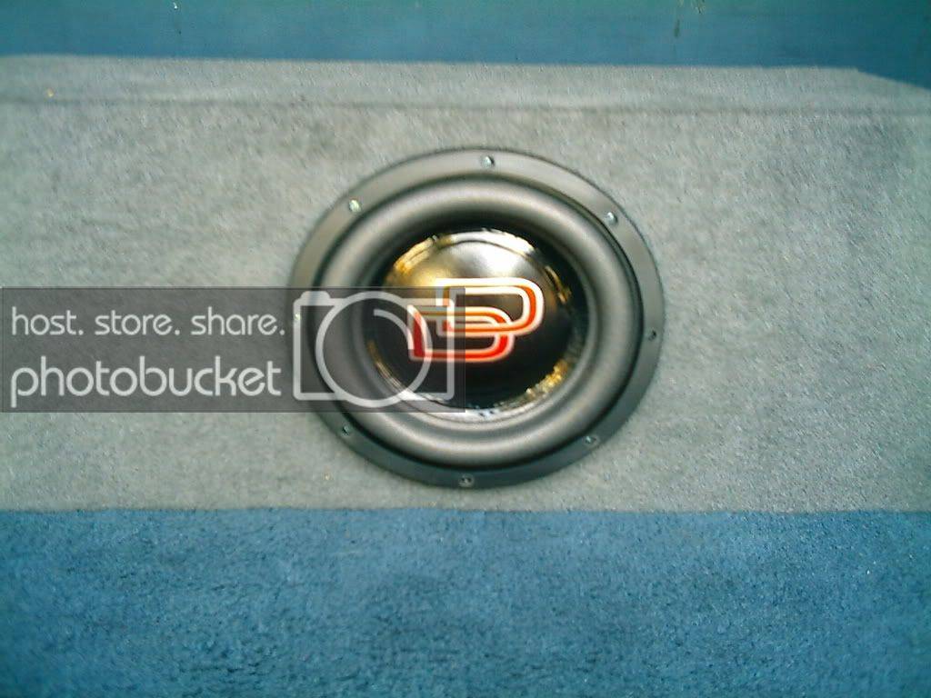

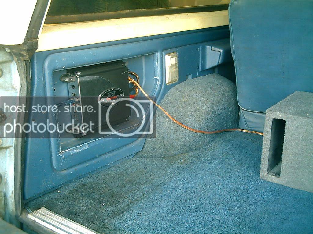

nothing special but iam starting to like it more and more as it loosens up some.
for an 8 its impressive and can dig very low and gets quite loud for only seeing 500rms right now. iam going to change to an mtx 81000d next weekend.
for now i am quite impressed
-vic
25.5w
10.0h
12.0d
the port is 1.75wide and 8.5tall. comes out to just over 15sq" of port area and i made mine about 23" long.(about 38 or so hz) after all displacements, the box is just over 1cuft.(1.05cuft)
the next box i build for it will have 16cu" of port and the same tunning.
