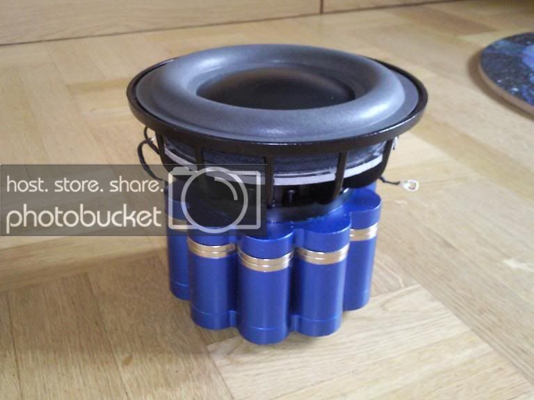

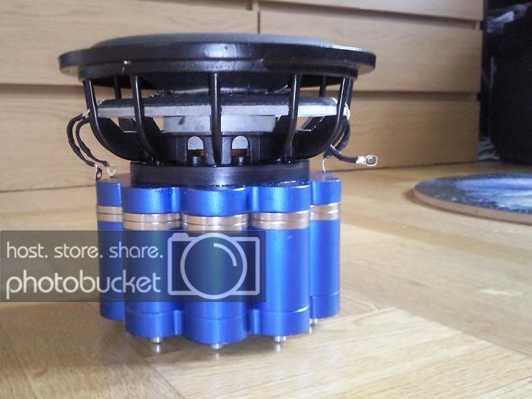

my friends neo 8" version 2..
sjobas
a little bit more of everything.. the last one with jl audio basket played 142,2 in a box that played music well, and in a car (mercedes) not so good for numbers,
this one is not finished yet, but it will be good he think //content.invisioncic.com/y282845/emoticons/smile.gif.1ebc41e1811405b213edfc4622c41e27.gif
Why didn't he like the JL basket?
he does, and he still use it, but since it have so strange surround he will try to dont brake it, so with the new model there will be no problem if he blow it, just buy new parts and recone it //content.invisioncic.com/y282845/emoticons/smile.gif.1ebc41e1811405b213edfc4622c41e27.gif
that is not a problem right now, it is the surround being the "weak" part and setting the limits and dont allow it to travel so far..
I like that spider landing...I'm sure it allows for a more substantial spider
Than the JL? I dont remember the W7 8's spider size off the top of my head, but based on its xmax potential versus its competition, the 8" W7 does not have an inferior spider landing size. But the OP makes a good point about the proprietary surround potentially causing problems down the road.
I was comparing this modified basket landing to the conventional style 8" 12 spoke basket.
